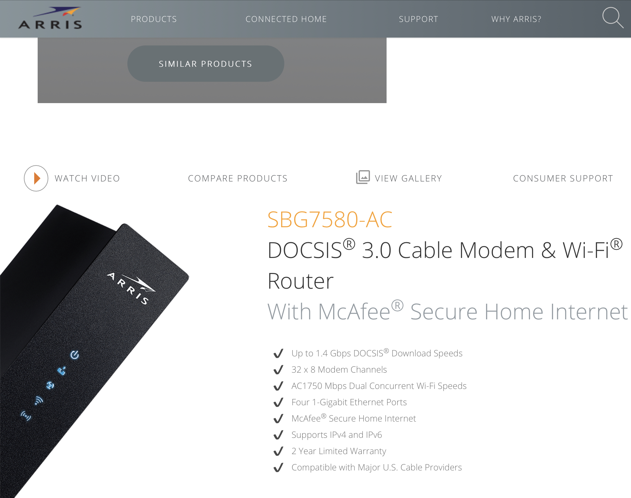

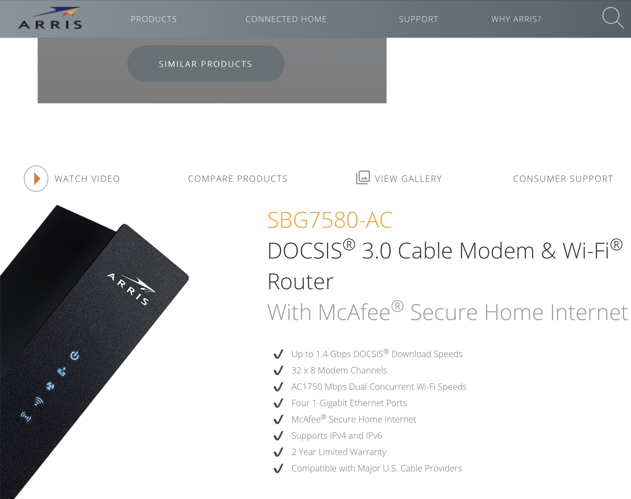

Here’s the modem/router Suddenlink gave to me. It says the WiFi speeds are definitely capable of more. Also, I have both 2.4 & 5Ghz enabled.
Looks like the iPad is connecting via 2.4 band, as a router like that will deliver up to 450Mbs on the 2.4, 1.3Gbs on the 5GHz.
Maybe some settings on the modem re: individual SSIDs and setup iPad to only connect to 5Ghz band, but will be giving up range for speed.
Again, I appreciate your thought and input.
However, my iPad only connects to the 5Ghz, as I only use it within decent range of the router.
Have you explore the wireless advance option? Some router like ASUS with Merlin firmware can show the connected speed. My Max is connected at 866mbps on 5Ghz band but actual download speed 475-570mbps on my device. Is your router configured to use AC mode with maximum channel width 40Mhz instead of 20 using non-overlapping channels? You will also need to account for interference if you are in an area with multiple AP using the same channel.
Hmmm...this is above my current realm of “expertise.” I’m open to learning though. Any suggestions of how/where to start?

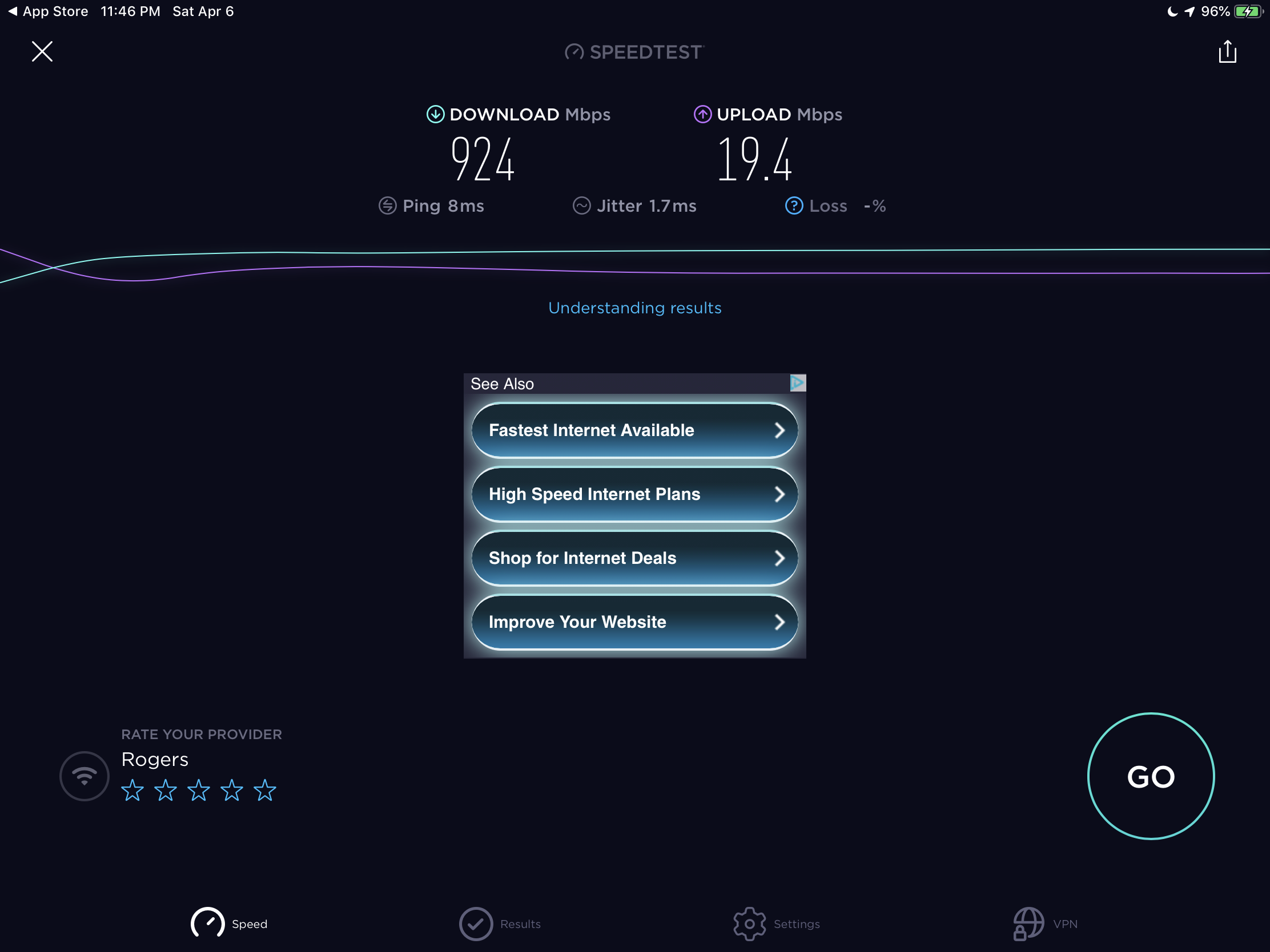

There is a user on here with 1GBit home internet. And he is passing those speeds with his iPad Pro 2nd gen easily. I’m certain he has a quality internet router and the correct settings too.

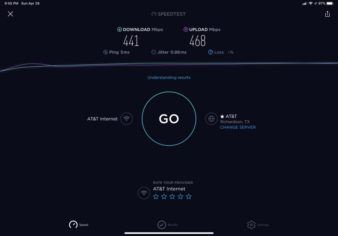

I have 1Gbps home internet. I'd like to see someone get greater than 550Mbps over Wi-Fi.
I sometimes do a bit better than this, but I consider this typical at my home (and pretty good).

His user name was @EugW hopefully he will chime in. I remember a screenshot he posted, and it was over 1Gbps on his WiFi. I’m pretty certain it was tested on his iPad too. I also am certain he has a quality router. We’ll see. He should reply.
His user name was @EugW hopefully he will chime in. I remember a screenshot he posted, and it was over 1Gbps on s WiFi. I’m pretty certain it was tested on his iPad too. I also am certain he has a quality router. We’ll see. He should reply.
Physically impossible 🙂

No, that 900+ Mbps I got was over Ethernet. (Yes, wired Ethernet works on the iPad Pro 10.5”.)
With WiFi it's more like 500 Mbps, through an AirPort Extreme 802.11ac.
What I’m more concerned about is upload speeds. My provider is in the 20-30 Mbps range (cable).
