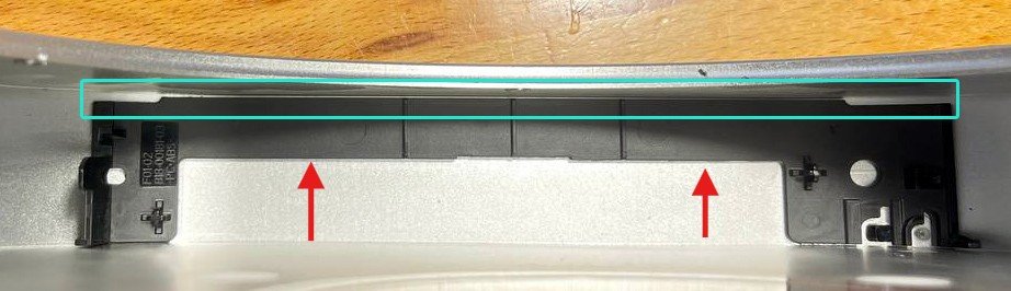

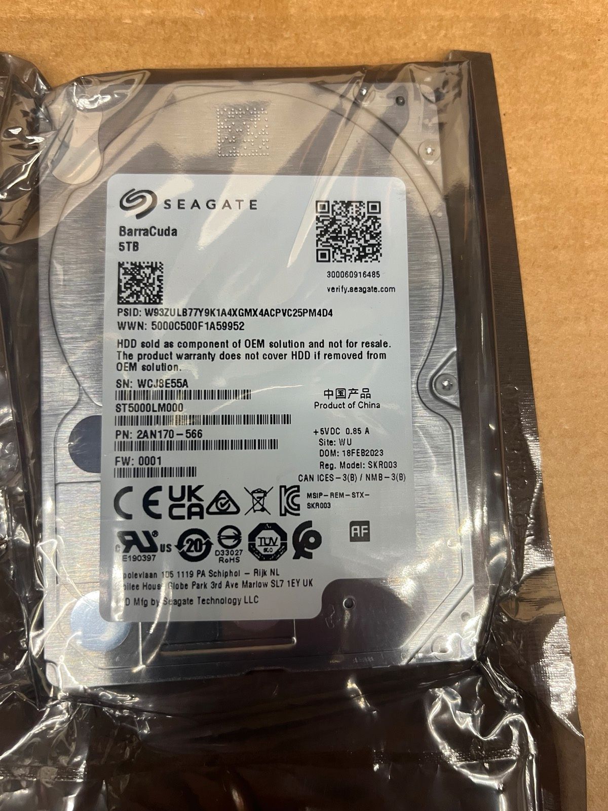

I installed a Seagate ST5000LM000 5TB hard drive into a Mac mini Late 2014. The drive is twice as thick as the original 7mm one that came with the Mac mini, but I still managed to fit it in.
The installation is hindered by two guide rods on a black plastic bracket located at the front inside the case, which holds two guide bushings. To make everything fit easily, you need to remove this black plastic bracket (it’s attached with double-sided tape) and shave off 2–3 mm of plastic from the top of the bracket.
This will allow you to lift it slightly, making it possible to install a thicker drive than the original. It’s a tight fit, but it works perfectly.
