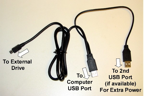

Try a Y USB Cable, if the drive needs more power than the USB port on the computer can deliver it won't startup correctly, you could also use an external power supply if the external has a port for it.
It has an external power source!
