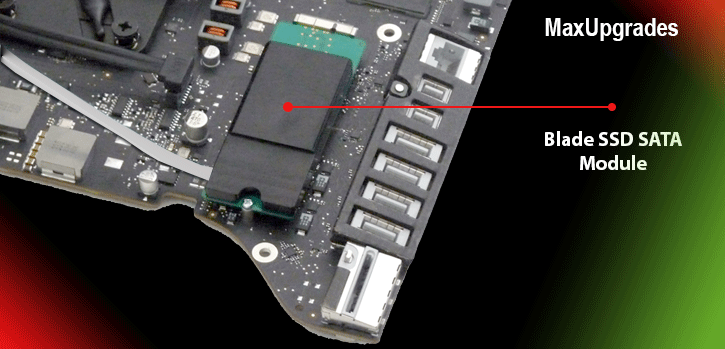

the picture is a little deceiving. it looks like all you have to do is take the screen off plug the ssd in and plug the blade in and done. the blade connector is on the underside of the logic board and requires complete removal of the logic board.
I think the second picture clearly shows you the Logic Board must be removed, considering that you are looking at the ports.
