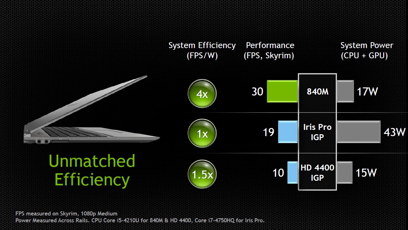

Anandtech has shown this slide some time ago:
I wonder if Apple is willing to sacrifice efficiency in the name of space savings. Unless the slide is ********?
I've read other articles which state that Iris Pro is far more power hungry than a dGPU. Anand is likely correct
If the past is any indication, they sacrifice it for performance. In absolute efficiency you don't gain anything with Nvidia, you only get more performance under full load, a use case in which the battery of a Mac is dry in 1h or max 2h. At low loads the 840M would even hurt battery life if it couldn't be turned of thanks to Optimus.
Also Nvidia compared to Iris Pro, with Broadwell Iris (28W) will get the edram treatment and things will likely look much closer.
BTW while 730M + 17W Intel is not much better than Iris 28W, the 840M + 17W Intel is certainly a big difference in performance and I doubt Apple is going to change the 13" Retina to offer a 840M equipped version.
