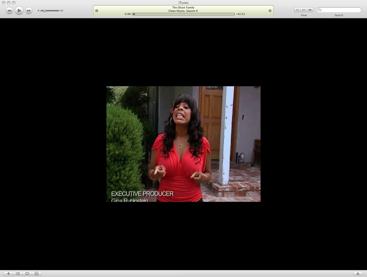

On the 24" iMac we also noticed a portion of the bottom of the image was cropped as well, and once could safely assume if it was cropped on the bottom the top was as well.
How did we see it on the iMac?
We replayed the show in the " Actual Size View " and stretched the iTunes window to insure we were not cropping it.
On the bottom portion of the screen on one show they have Credits.
When the Credit played on the iMac we saw the word " PRODUCER ", under the word " PRODUCER " we saw the top half of the producers Name. We looked here because when played on the TV via the ATV all we saw was the word " PRODUCER " and no part of the producers name.

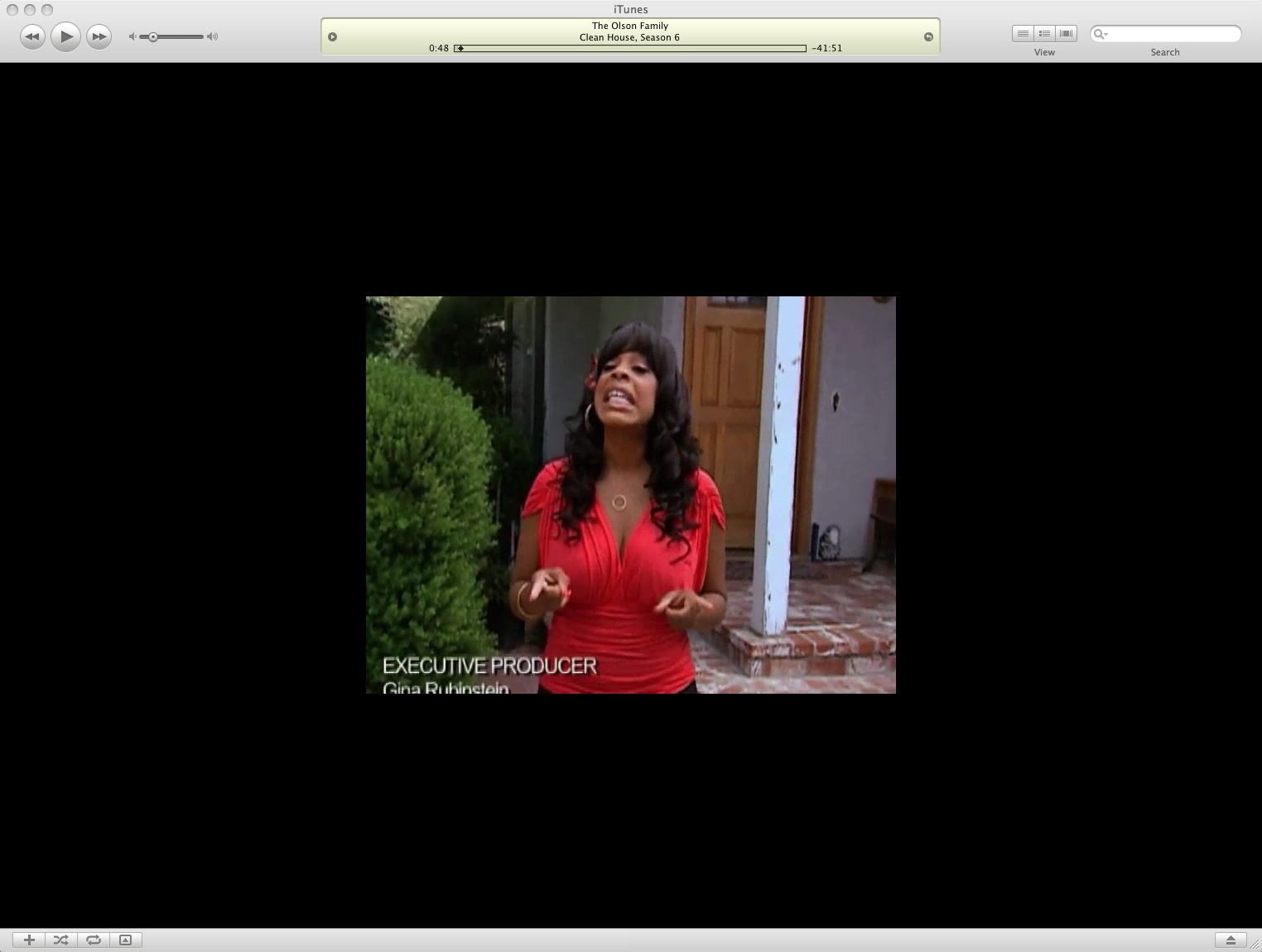

OK, I'll agree with that ... but the fact remains that on playback via iTunes on the iMac we still saw the cropping ....
See pic below.... ( when played on TV via Apple TV the Producer name is completely gone )

I posted a screen shot from the iMac where you can see in the Credits the Producer name is partially cropped off, on the TV the name is completely cropped out.
I am realizing that this is some sort of limitation within the Hardware/Software and something that I will have to learn to live with.

Looks like a case of poorly aligned graphics not placed in the safe crop zones of a NLE.
Would this explain the fact that the Apple TV is cropping off more than what is seen on the iMac?
Think of it like this .... there is a name displayed on the lower left hand corner of the frame. That is the name of the producer.
On the cable tv viewing the name if fully present.
On the iMac viewing the download from ITMS the name is partially present.
Streamed from the iMac to the TV via :apple:TV, the name it completely gone.
I could understand it being partially lost in the NLE as it was prepared for distribution on iTunes, but that doesn't quite explain further loss from the iMac to the TV through the :apple:TV. Does it?

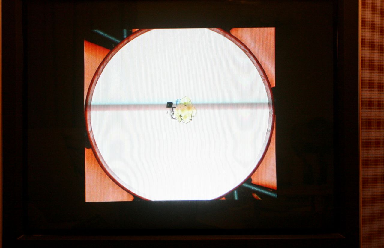

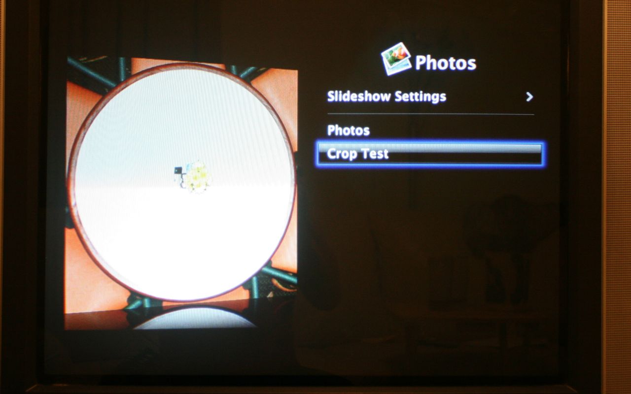

EDIT: Just did a PHOTO TEST with interesting result .... adding pic .... be right back!
Look at the picture of the round table show here. This is at it appears in iPhoto. I created an Album called " Crop Test " and put the photo in there.
I then SYNC'd it to the Apple TV.

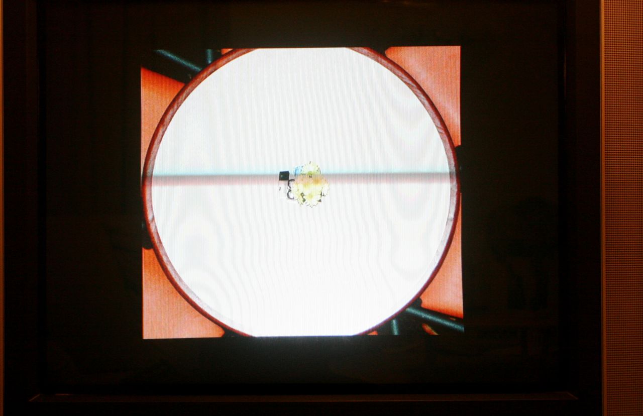

The picture was clearly cropped top and bottom by the Apple TV in Viewing Mode.
HOWEVER ......

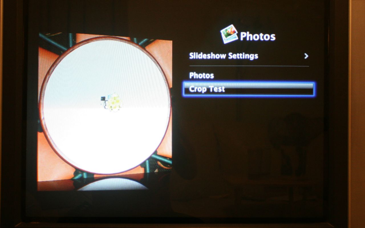

Before I selected the Album to be played, a 'thumbnail' was displayed on the TV and it showed the entire round table. Only when I pressed PLAY and the pic came on full view was it cropped. The crop was so severe that it came up from the bottom and down from the top clear past the wood border around the table.
Something is clearly happening between the Apple TV and the Sony TV. I was beginning to believe it has something to do with the DVI input. Remember the cable I have between the ATV and Sony is an HDMI-->DVI, and maybe the TV itself, but a previous poster said he saw the picture cropping on his setup which was straight DVI-->DVI
The two added pics show screen shots of MENU and VIEWED. You can clearly see the areas above and below cropped.

That is EXACTLY what it is.
The iMac must have something internal to its software that crops the image because when multimedia files are prepared, the entire video plus overscan outside the tv-safe region.
I asked the extra question about whether it was produced in the UK because those TV-safe regions are taller to conform to the 576 line vertical resolution of PAL. However, it needn't be the case.
All that seems to have happened here is that the show's producers/editors keyed the graphics over the edge of the safe region boundary.
Then, when iMac's software cropped it (as seems to be the case for any multimedia file made from a TV show or motion picture digital intermediate... otherwise you might see all kinds of odd junk) it got cut a little. When AppleTV displayed it, it may have cropped it and/or rescaled it up... pushing the graphics even further out of TV-safe. You have to remember that files purchased from iTunes are not 720x480 DV NTSC or 720x486 CCIR-601 (D1 NTSC)... so some rescaling is required on a TV, and some cropping is required on a monitor (because computer monitors do not have fixed NTSC or ATSC resolution).
But this is perfectly fine if the program is edited properly with all title keying done within safe-lines and according to the geometry of the intended aspect ratio.
It's also possible the original TV segment was done properly but the masterfile provided by Style TV was already cropped incorrectly.
Making matters worse is the fact that it sounds like the OP isn't even using a widescreen HDTV. The reason Apple has this requirement probably has a lot to do with the conformity of the field in view when upscaled because currently ALL of the TV content (excluding podcasts) mastered in standard definition has been sold through Apple iTunes Store at less than DV NTSC resolution... Consequently all this content has to be rescaled.
I don't imagine this last issue will continue to be a factor as Apple pushes out SD and HD rentals at full SD and HD resolutions, and when they introduce iPod/iPhone displays capable of outputting at 720x480 resolution.
Of course the output resolution of the source files may always be hindered as long as content producers seek to use this as one additional means of making it difficult to distribute high quality cracked copies that could be burned to disc and sold on the black market in foreign markets.
That explains the video perhaps.
Care to explain the photo, created on the iMac, looking good on the iMac, yet being cropped when displayed on Apple TV.
This is evident on two TV's one a widescreen, the other not.
The poster that has the widescreen setup went so far as to say that 32 pixels are cut from the top and bottom.
You can see this in the photos I provided.
It does seem as though the edges of the image were pushed beyond the viewing area. He did his testing on a
Samsung 57" DLP HDTV
In all honesty I had not gotten to test photograph until that was brought up.
The pictures I posted are of a round table, I shot from overhead.
Using iPhoto, I cropped the picture so that the edges of the round table met the edge of the photograph. Looked perfect on the iMac, of course because it was created there. But you can see what happened when played through the Apple TV.
And in being honest the clipped edges of the table are at the extrememes of the 'viewing' area on a non-widescreen tv.

I wanted some fine art (paintings done by artists) as screensaver "photos" on our Apple TV. My wife and I like art from the Impressionists on, including Surrealism, Expressionism, etc. So I downloaded a ton of (free) art images from the internet. I loaded them into iPhoto, examined them in an iPhoto slideshow, and eventually uploaded them to the Apple TV. This was where my problems started.
It was immediately obvious to both my wife and I that the images were being cropped -- tough to miss on art, easy to overlook on a snapshot.
So I opened photoshop, did some tests with format, pixel shape, borders, etc. What I came up with was that if I bordered the top and bottom of the images with 32 pixels of black, the black would almost completely disappear on the HDTV when looking at a slideshow.
I thought that perhaps the Ken Burns effect was "reserving" a border in order to slide the image around, so I turned this effect off. Same result: serious top and bottom cropping.
720p -> HDMI -> 57" 16X9 HDTV (Set to 16X9) Cropped
1080i -> HDMI -> 57" 16X9 HDTV (Set to 16X9) Cropped
etc.
No matter what I set, the AppleTV was scaling up the image such that 64 pixels (total) were being cropped.
They aren't cut (not on TV anyway). They're there, behind the plastic molding. Want a display that extends past the safe regions like a computer? Well, then you have to contend with the ugliness and inconsistency of non-matted images. By matted I mean that the edges that cover the safe area act as a matte. Without this, any kind of slight inconsistency in aspect ratio will be visible and some programs will have a line here a line there... a boom mic edge... all sorts of goodies.
No it's not because it was "created there"... it's because of two things.
1. The image you created has square pixels.
2. The Mac monitor displays square pixels and has no "tv-safe boundary", the output signal ends before it meets the edge of the visible area of the display.
If you want to format your images for TV as opposed to a computer monitor, then you need to do a few things:
1. Use safe region guides to frame your shot either while photographing or when resizing the image, but do not crop the edges outside the safe regions.
2. Scale the image to match the output resolution of your TV.
3. Change the density to 72 pixels per inch.
4. Ensure the pixel aspect ratio matches the display (0.9 for SD, 1:1 for HDTV).
