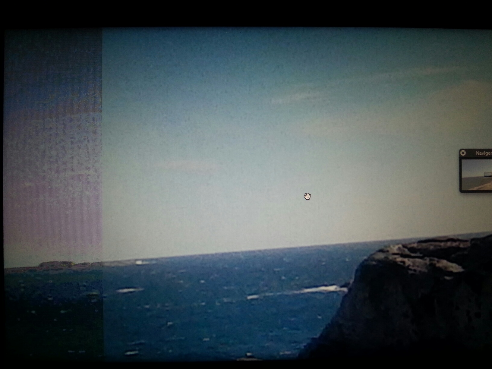

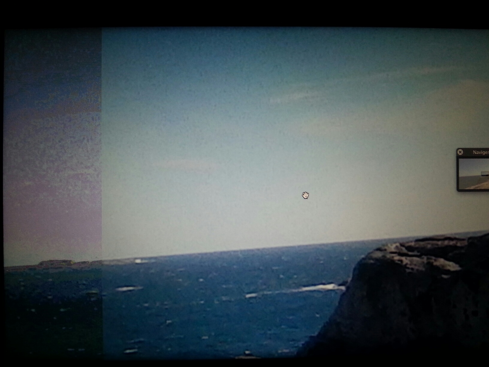

I was at work, carefully wiped the screen with a damp cloth as always.
No immediate problems. Then I had to move my computer and closed the lid.
As I opened it a little over 1" wide vertical line at the left of the display had appeared. It´s multicolored and flickers. Super annoying. Minor panic ensued.

The stripe does not appear in screenshots.
It does not appear to be a pressure issue seeing as how even the stripe is.
Thing is, I did not do anything I haven´t done before, so it seemed to appear out of thin air.
I attached photos.
Is this the result of the wiping or could it be magnetized or the result of static electricity?

I find it really strange how perfectly straight the line is. Is it possible that damage from liquid or pressure appear so straight?
What else could have caused this?
Anyone know?

I had a nice chat with Andrew at technical support. He was very willing to help and suggested a SMC or PRAM/VRAM reset. the SMC did nothing as far as I can see, the second the screen went from black to grey at startup, the stripe was there.
Then I did the other reset the PRAM/VRAM. The grey screen had NO stripe!
Neither did the login screen!
But then, dognabbit! As soon as I was logged in, there it was. Tried it again, same result. The stripe disappears from the grey screen and the login screen, but then it´s back. Imagine the frustration.

This is more than likely a faulty LCD panel. I've personally seen 5 (my personal MBAir along with 4 others I've repaired) 11" MacBook Airs (from 2010 until now) with similar symptoms and vertical discoloration/lines is a typical symptom of bad LCDs anyway. The color variation could be only visible on certain colors/backgrounds. Apple would likely run an LCD color test that places flat colors and gradient colors on your LCD to see where the issue occurs.
Apple would need to replace the display assembly, which is a straight forward process. If the part is in stock and their repair queue is short you'd probably have it back within a day or so. I'd take it into Apple or an AASP (find an AASP) and have them diagnose & repair it. It will certainly be much less fuss than dealing with AppleCare and forums on the internet.
In regards to liquid damage... It IS possible for liquid damage to cause something like this but in my experience you're much more likely to instead see no backlight, no video, cloudiness in the display, etc. From what you've said I wouldn't expect liquid damage when opening up this MBAir.
