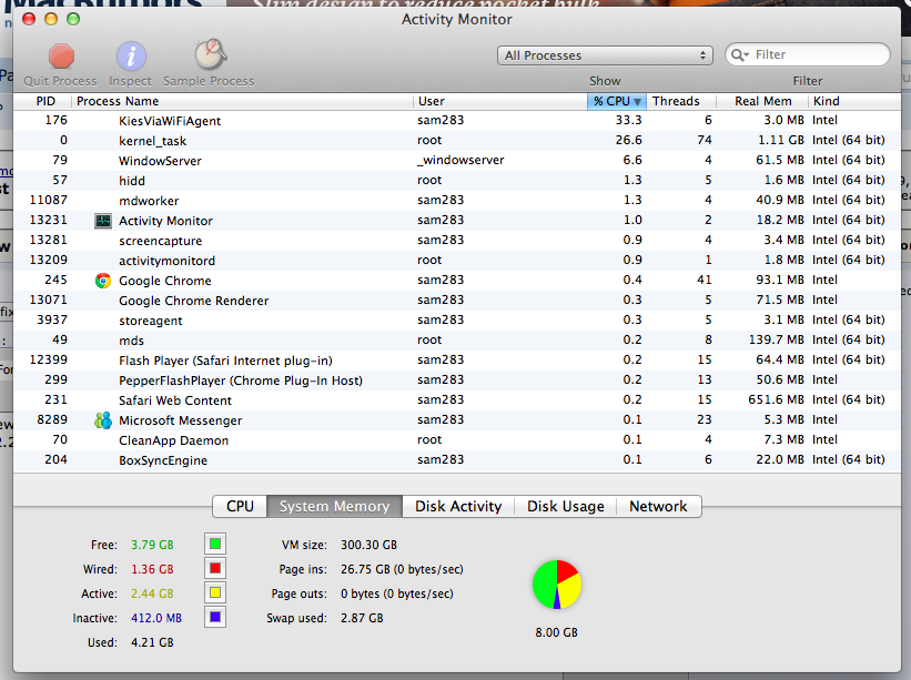

Till few months back my MBA 13, 2012 battery life was 7 Hours. Right now it is just 2.2 hours. This is horrendous. Not sure what to do.. Please advise.
Please find All Process details.

Yeah I read the same section and tried all and then posted this question. Can you help me pls?
Your screenshot shows two top processes taking quite alot CPU. Are those constantly like that? If yes, thats your problem...
My 11" did the same but the Apple store replaced it for free after getting the go ahead from Apple Support.
Try uninstallling Samsung Kies. Do you really need that program? Try using an alternative, if you can. Then do a restart and check if the top process is still there. Samsung Kies is a horrible program and trends to ruin your batterylife by these type of processes. Hope this helps!
I removed Kies.. it seems to help and increase my battery life.. but still its not near original 7 hours!
