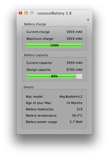

After over 300 cycles mine fluctuates between 88 and 92 percent capacity.
