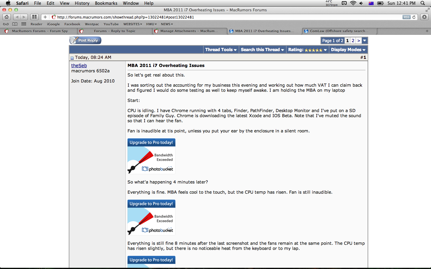

When I look at the OPs I don't see any images other but the Bandwith exceeded images..

Oops. Looks as though photo bucket failed me. Any other hosting sites that you can suggest?
I've decided that it would be better to upgrade to photo bucket pro for $2.99 than to waste my time uploading elsewhere and relinking. It just makes financial sense. 🙂

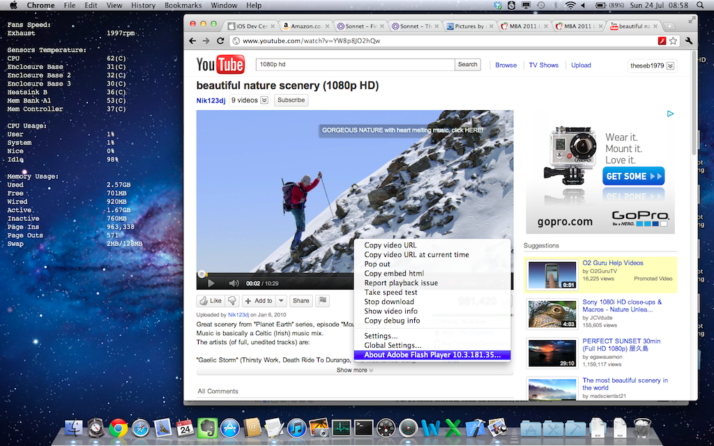

I was busy "poncing about on the computer", as the mrs calls it, so I did not allow the MBA to return to idle temps. This way it's a more realistic test of doing stuff and then immediately watching a 1080p YouTube clip. You can see what version of flash I have.
So the movie is now playing and CPU hovers at 5-7% busy.
I let the download buffer for a bit and I am playing the clip again
CPU Usage remains where it should and so do the temps. Enclosure temps are excellent.

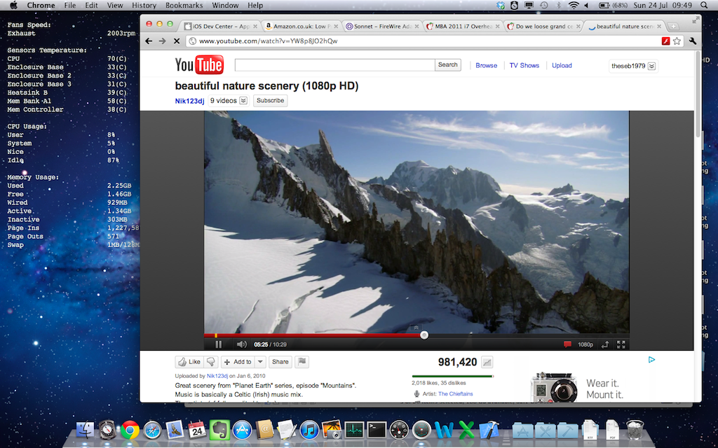

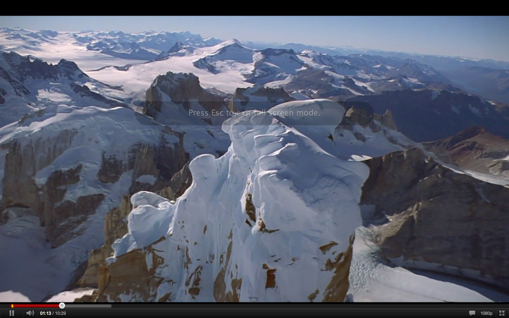

Just a quick update. I've watched the clip a couple of times now. Temps hover around 66-70, depending on what I am doing in the background. To explain further, I left the clip to play on full screen, but I check the temps occasionally. I've noticed that if I am doing something at the same time as the clip is playing, the temps rise about 1 or 2 degree, which is normal.
Enclosure temps remain great and only the very top left corner is warm along with the Esc key, but I can keep my finger there indefinitely without any discomfort (this was a major issue for me on my previous MBP). Fans have not ventured past 20xx. The sound is muted and I am sitting in the lounge with nothing else on (the mrs is still sleeping).The Sky HD box (kind of like your Tivo thing for those in the US that have no idea what I am talking about) is about 3 metres away from me. It is on standby and I can hear it. I cannot hear the MBA until I put my ear right by the top left corner and then you can hear the fans. They're working away happily and very quietly. One thing to note in all of my screenshots is the Heatsink temp. Does anyone know where the sensor is located? It seems to stay at a very reasonable temperature.
80C+ and the fan is not running pass 4k? Looks scary to me...
Heatsink and enclosure temps remain at acceptable levels. I would imagine Apple is still looking for the perfect trade offs between fan noise and CPU temps with these computers. CPUs are designed to run at hotter temps than what we're subjecting them to. I do quite a lot with my computers. It's my bread and butter, my passion, and my hobby. If the chip fries, I'll get another one. 🙂
