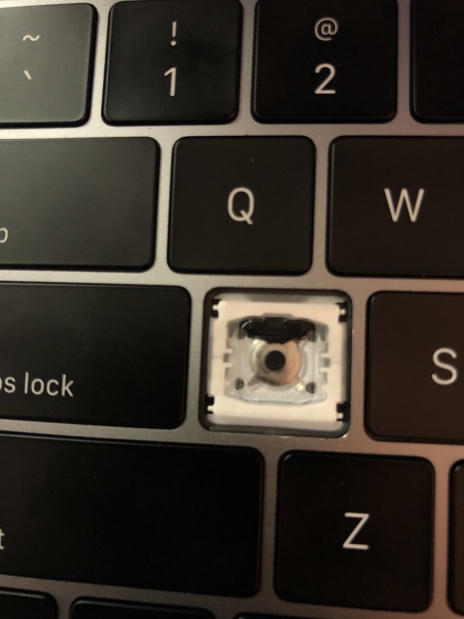

So I was having an issue with my "A" doing double presses and so I tried to pop off the key and upon re-installing it the travel is not nearly what it was before, and none of the posts in the butterfly mechanism seem to be broken in any way.
I have set up an appointment at the Genius bar since they have a repair program in place, wondering what the turn around time on this would be from anyone who has got this done before, and what exactly do they do ?

Yes I met with Apple on Friday and they gave the repair the green light, however the part wass not in stock so they had to order it. I got a call Saturday saying the part was in so I will drop it off either tomorrow or Tuesday for repair !
