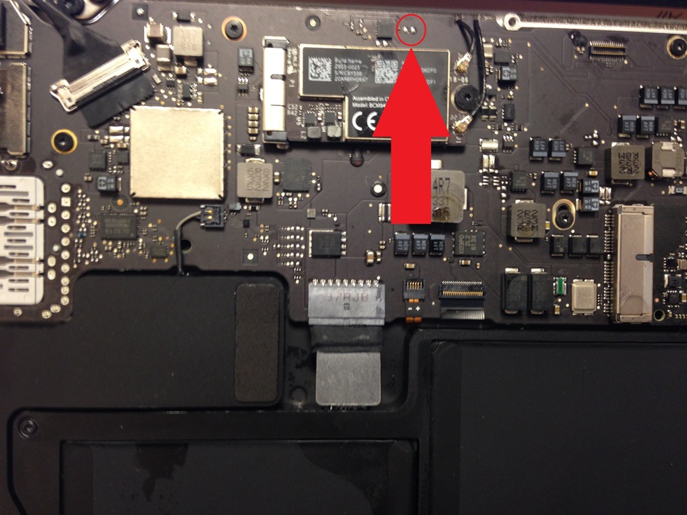

I suppose it´s here.
also same location on the other side of the board.
Yes, I took the board out of the computer. Cleaned it with a toothbrush on both sides with plenty of pure alcohol. I have the left the keyboard/trackpad unconnected.
Unfortunately shorting the two pads you suggested does not do anything :(

do you have a multimeter ? measure voltage on pads I showed. one should be 3.x
A1466 Schematic HERE!!
power on is also pin-11 on trackpad connector (mobo side). short it to ground to power on. (or test continuity from p11 on trackpad to pads I showed -- one of them should beep.) if so -- then they are power on pads.

yes, power button!! (or pads I showed You before) :D

power button on air's is embedded in keyboard, but not directly connected to keyboard.. dunno how to explain. --- basically = pwr button does not go through the whole keyboard thing, but has seperate pin on the connector. (pin 11) -- so holding button on keyboard would be the same as shorting pads on mobo.
