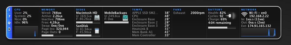

If you're not already doing so, use iStat Pro (free) or iStat Menus ($16) to get accurate readings of your temps, fan speeds, etc., rather than relying on your sense of touch or sound. A forum member has posted a copy of iStat Pro that has been "tweaked" to enhance compatibility with recent OS X versions. You can download it here.

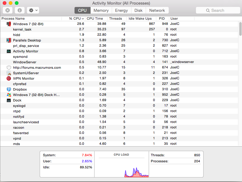

Please go to the Activity Monitor and click on either the CPU or Energy tabs to see what is using your CPU power. This is almost certainly causing your computer to heat up.
Although it fluctuates quite bit I have included a screen shot from Activity Monitor, any insights...it seems that Parallels is using a lot of CPU processing...worth perhaps doing is trying o use my MBA *without* Parallels a seeing how hot it gets.

I have also posted a screen shot from iStat Pro, any insights...granted that when the screenshot was taken the MBA does not seem warm / hot.

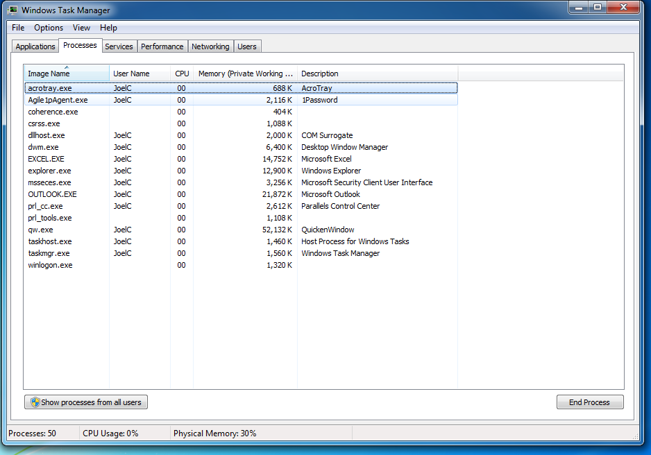

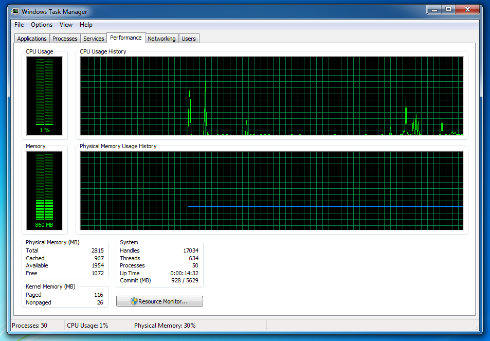

Attached is a screenshot of Windows' VM's Task manager...I don't see anything abnormal, do you or anyone else?
Nope, looks fine. Odd. I went back and looked at your screen shot of iStatPro or whatever it's called, and it's showing that your fan is running at 2000 RPM and the CPU temperature is 48 degrees, which is consistent with an idle system. And all the other temperatures are lower.
Are you sure the computer was hot when you took the screen shot? Because I'm kinda guessing that it wasn't.
Please realize that the amount of heat your computer puts out is dependent on what you're doing with it at the moment, it's not a constant. If you start running something intensive (in a VM or not) then it will heat up in less than a minute and as soon as you stop it will cool off in less than a minute. So just because it gets hot sometimes doesn't mean there's something inherently wrong with it.

2. The iStat Pro image that was posted was *before* starting the VM to show the fan speed in response to the previous comment / poster.
3. The Task Manager image is when the VM has the normally loaded apps running.
