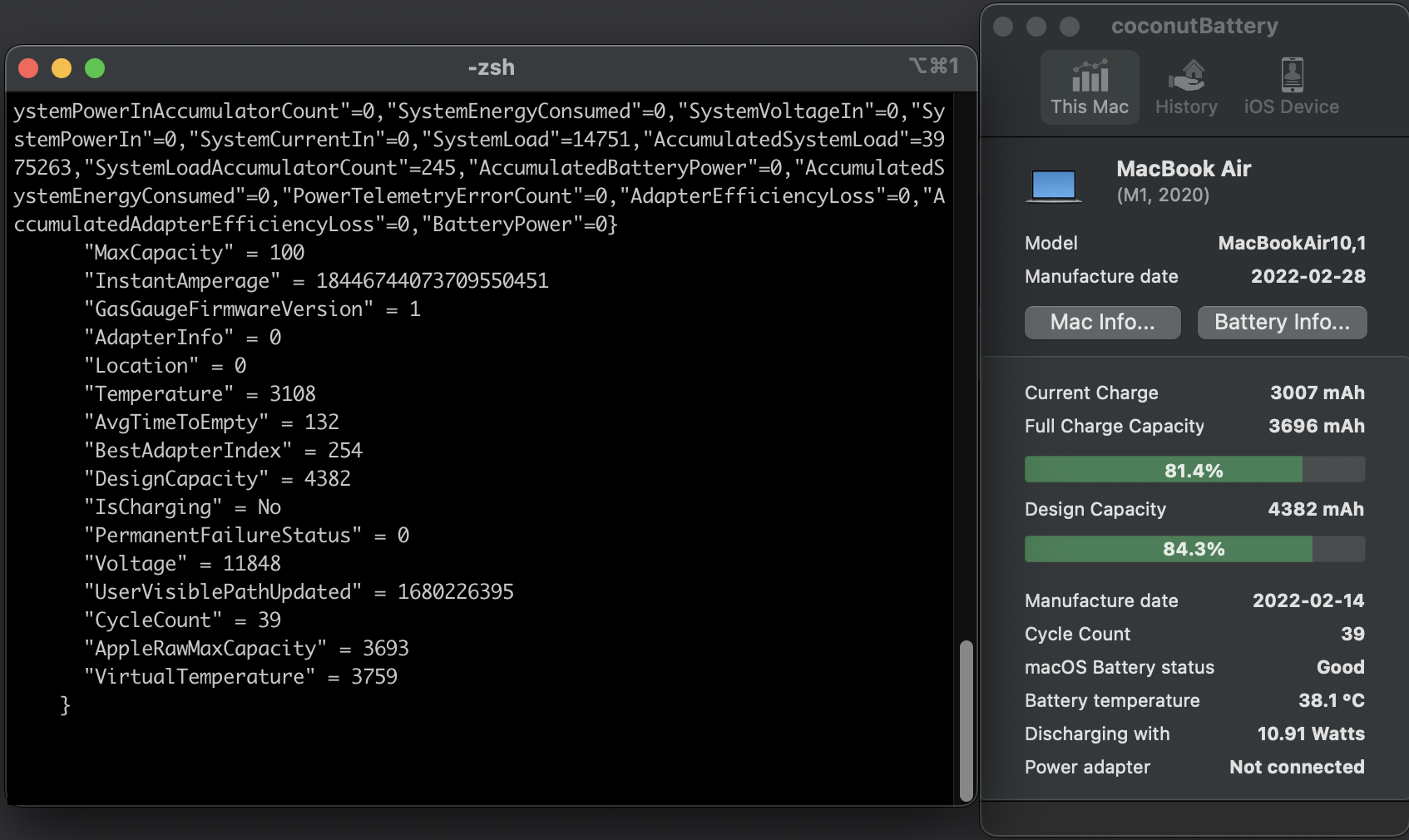

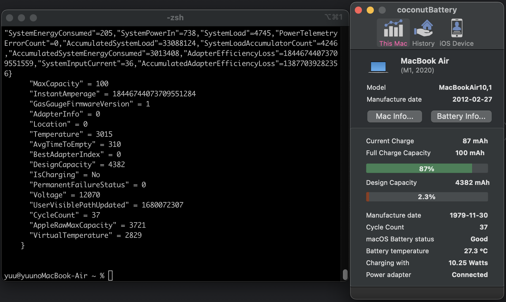

Hi,
Attached my battery health from terminal and coconutbattery. The numbers look off, is it a problem with the app or my MBA?
My MBA M1 (bought in Apr 2022) 's battery health is currently 90% at 37 cycles. It's plugged almost in all the time. Used al dente for awhile last year and went from 100 to 97 so i stopped. Then it seems like in November i went for a 10 day vacation (MBA turned off at home) and came back to it with 92%. (Not sure whether this is a thing...? I don't check the health that often but could have sworn it was around 97 before i left...)
My limited warranty expires next week (don't have +) so i'm just wondering if this is an issue and i should bring it to apple for a diagnosis?
If reseting SMC does not help, take it to Apple. This is weird and if this still has warranty, it is Apple problem.
The numbers you got in the terminal are much more accurate. Something is wrong with your Coconut Battery and you should probably update it to a newer version.
It does look strange. Have you tried resetting the SMC? https://support.apple.com/en-us/HT201295
It's a M1 MBA so according to Apple there are no steps other than to restart, have restarted multiple times and still the same.
Thanks for the advice!
I tried the latest version but it could not work on my MBA (Ventura 13.2.1) so i tried the next older ver which gave me the above results.

Was indeed a problem with the version! Updated to 13.3 and numbers look alright now.
