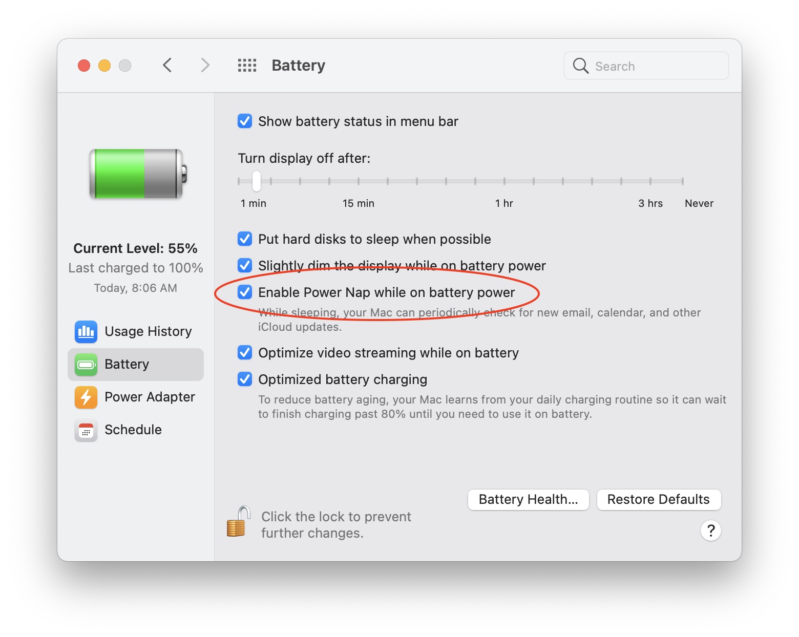

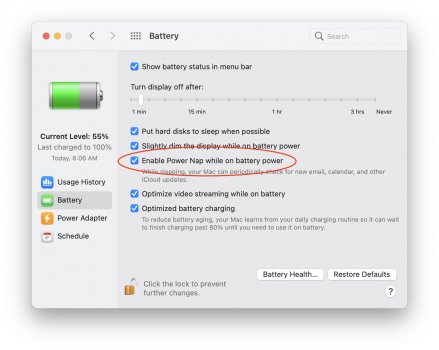

It's probably a normal part of macOS called Power Nap.
You can turn off Power Nap in System Preferences > Battery if you don't want it to do that.

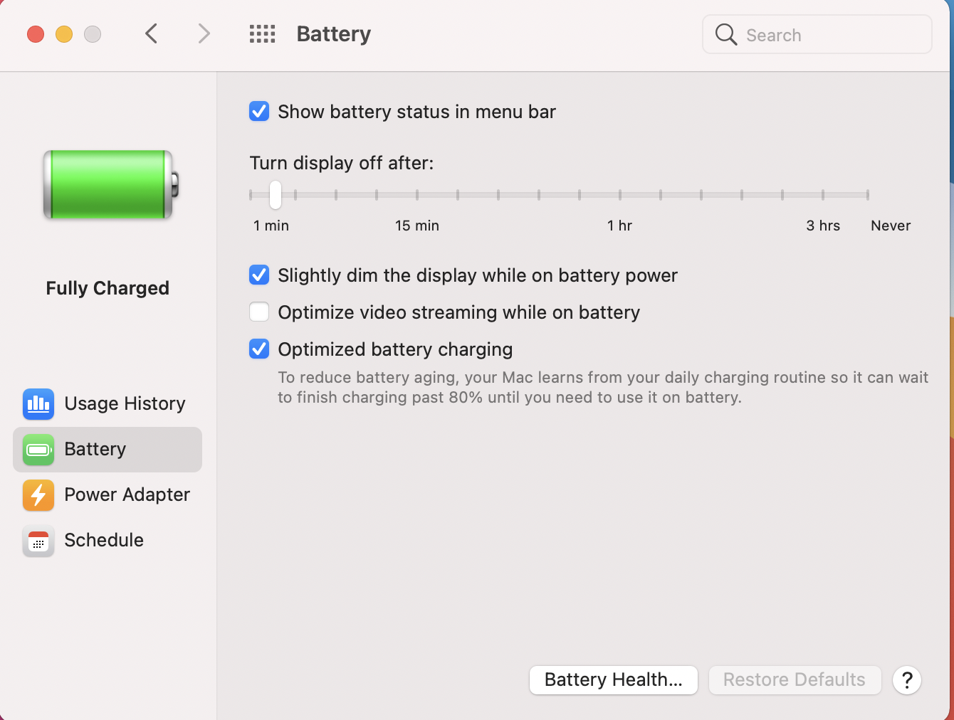

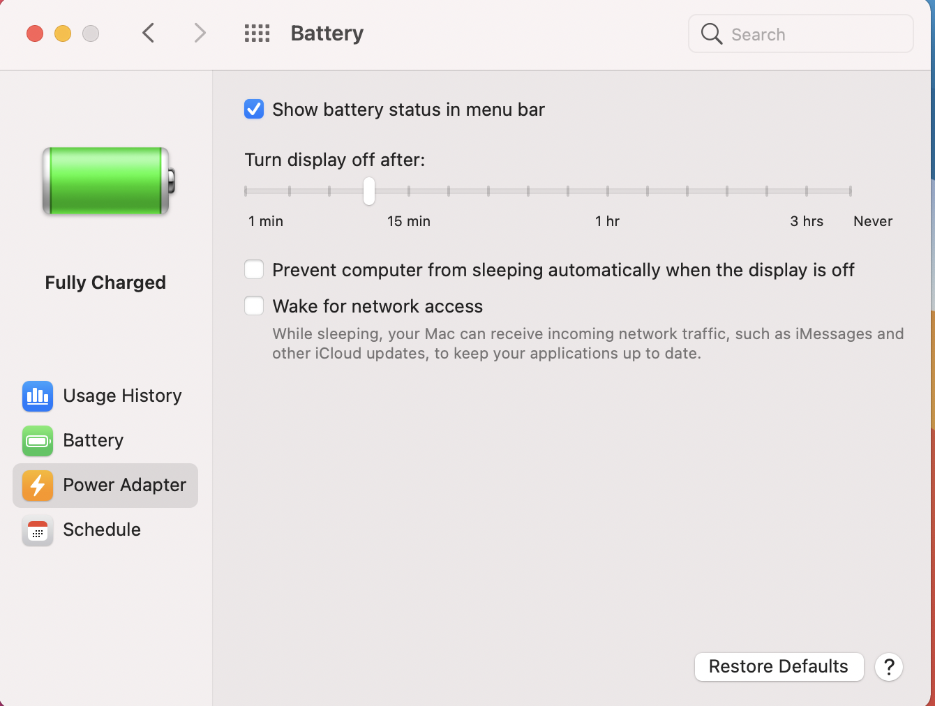

The issue is that I am seeing the battery drain more than expected while it is sleeping overnight. I am getting those events about every five minutes, even when I have "Wake for network access" disabled.
...even when I have "Wake for network access" disabled.
"Wake for network access" means that it will wake up when an external network event tries to communicate with it. That's not related to Power Nap. Turn off Power Nap and you should be happy.
Since you're concerned about this happening overnight, you could alleviate this by plugging it in.
