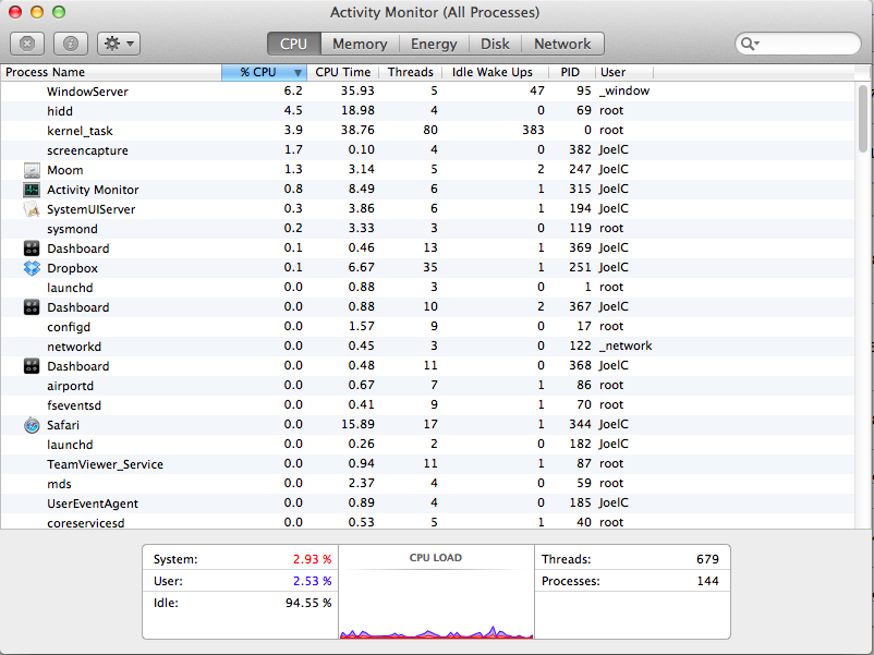

Went to activity monitor to see whether there were any background task(s) that were using CPU but could not find any though I did notice an task labelled WindowServer that was at the top of the list.
Would appreciate feedback on the screen shot I attached because I don't really know what to look for.
TIA,
Joel
PS. I don't have Adobe Flash on the MBA!
