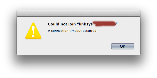

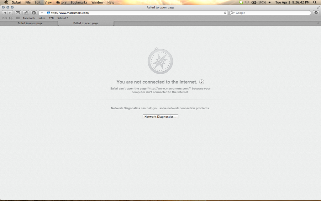

    So my MBA keeps dropping wifi for some reason. It happens ONLY on my home network, and ONLY to my computer. I'm the only mac on the network. Every other wifi network is perfectly fine, every other computer on this network is fine. Many things can happen. It could say it's connected, but not be able to access the internet (whether it tells me that there's no internet access or not). It may just drop wifi altogether, and refuse to connect (see pic).
    Generally, if I unplug the router and plug it back in, it's all good. It also works if I restart my computer. This happens multiple times a day. Yesterday I did everything I know to get it to connect (restart router many times, restart my MBA), and nothing worked. Eventually it just magically worked.
    How can I stop this from happening? We got a notice from comcast a while ago saying that a bot called DNS Changer was detected on one or more machines on the network. I'm assuming that this can't be me, right?

    What linksys router do you have. When I first got my iMac I had a issue where my wifi would disconnect and reconnect about a minute later. This would happen every 10 minutes or so. I came across a thread that said I should update my router firmware and see if that helps. Fixed my issue right after I did that. My router was a linksys WRT54G.

    General troubleshooting tips...
    Make sure you have the latest Linksys firmware on your WRT54G (beware that there are many different hardware revisions of the WRT54G, and many devices with similar model numbers, so be sure to get your model number and hardware revision exactly right when you go to the Linksys website looking for the latest firmware version). Update your Question with your hardware revision and firmware version and exact model number of your Linksys device.
    Also make sure you've applied all software updates to your MacBook Air. Update your Question with your exact MacBook Air revision (from System Profiler; like "MacBookAir 3,1") and your exact OS version.
    In case the channel your WRT54G is picking isn't the cleanest, try manually setting the channel. Try channels 1, 6, and 11, and see which one works best.
    Try to be specific with your description of symptoms and troubleshoot different symptoms as different problems. If Wi-Fi stays connected but the Internet doesn't work, that's probably a whole separate problem that you need to investigate/troubleshoot/diagnose/fix separately from case where you fully lose your Wi-Fi association.
    What signal strength (RSSI) do you usually see from your AP in the spots in your home where you're using your MacBook Air? Hold down Option while clicking on the Wi-Fi Menu Extra in Mac OS X to see the RSSI and various other stats for your current network connection.
    What do your system log and kernel logs say regarding Wi-Fi or other network problems? You can crank up the Wi-Fi logging in Mac OS X using the /usr/libexec/airportd command, but the syntax varies between OS version, and since you didn't provide your OS version, I can't tell you exactly what to type. There's even a Wi-Fi Diagnostics app in Lion in /System/Library/CoreServices/, but I don't know if you're running Lion or not.
    Also note that the Linksys WRT54G was introduced in late 2002, so even if you bought your unit more recently than that, it's still basically a decade-old design. Maybe it's time to consider buying a modern AP. Your MacBook Air is capable of 300mbps operation, so it's a pity to keep it shackled to a decade-old AP that can only do one-sixth the speed.
