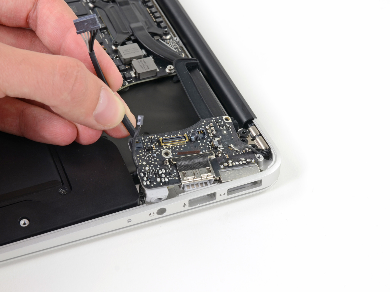

I've worn out/broken USB ports before which required expensive logic board repairs so I've come to most often use the USB port that isn't on the same side as the thunderbolt ports. The reason is that the USB port that isn't on the same side as the thunderbolt port is on its own daughter board which is much cheaper to fix/replace. Obviously if you have AppleCare it doesn't matter, but I tend to keep my MacBooks >5 years.
Good info. Thanks. I have a mid 2012 MBA with a USB port that will not accept a cable. I wonder what the cost would be to repair? Maybe I'll look into it. It's not on the thunderbolt side.
Below is the 2012 MBA 13 I/O board pics (the MBA 11 is similar, but the part is different), and ifixit sells it for $99
BZkpAxpCrTaGoVKZ.huge
If you're proficient or know someone who's worked on laptops before, it should be a relatively easy repair.
EDIT: Don't get it from ifixit, many places like this sell the 2012 MBA 11 I/O board for $35!
Here's a 2012 MBA 13 one for $37 here...
magbarn, than you so much for the additional information. Extremely helpful. Much appreciated.
If you're going to do it, remember the connectors are VERY FRAGILE. It's critical on how you remove them. I've seen too many ham-fisted individuals here ruin perfectly good mac mini logic boards by yanking on connectors or trying to remove them the wrong way.
Thanks. No, I don't have the skills to do this. I would most likely kill my poor MBA. I phoned Apple and MicroCenter today. Now it is a matter of deciding where to take my Mac.
Thanks again for the warning. Much appreciated.
