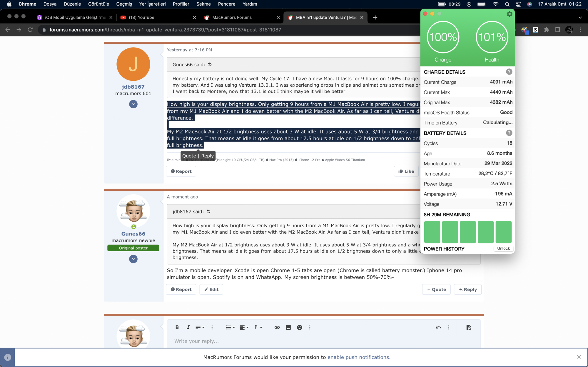

Honestly my battery is not doing well. My Cycle 17. I have a new Mac. It lasts for 9 hours on 100% charge. Maybe it will optimize my battery. And I was using Ventura 13.0.1. I was experiencing drops in clips and animations sometimes on desktop transitions, so I went back to Montere, now that 13.1 is out I think maybe it will be better
How high is your display brightness. Only getting 9 hours from a M1 MacBook Air is pretty low. I regularly got over 12 hours from my M1 MacBook Air and I do even better with the M2 MacBook Air. As far as I can tell, Ventura didn't make much difference.
My M2 MacBook Air at 1/2 brightness uses about 3 W at idle. It uses about 5 W at 3/4 brightness and a whopping 8.5 W when full brightness. That means at idle it goes from about 17.5 hours at idle on 1/2 brightness down to only a little over 6 hours at full brightness.

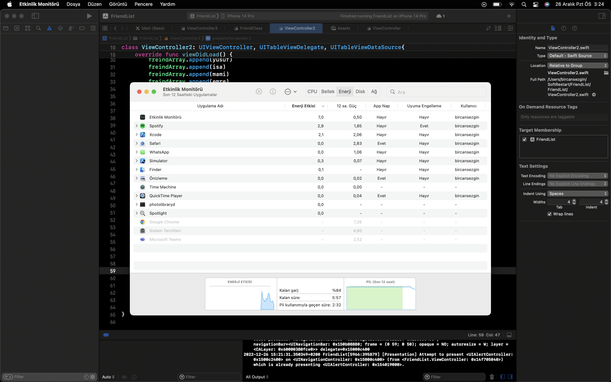

So I'm a mobile developer. Xcode is open Chrome 4-5 tabs are open (Chrome is called battery monster.) Iphone 14 pro simulator is open. Spotify is on and WhatsApp. My screen brightness is between 50%-70%-

9 hours with all that stuff running and you using the machine for dev work with 50-70% screen brightness seems perfectly reasonable. Nothing's wrong with your battery, and an OS upgrade won't help you get more life.
When Apple says things like "Up to 15 hours wireless web" (what they claim for the M2 MBA) you need to read the fine print and think about what their test covers and whether you can expect the same. It says:
  1. Testing conducted by Apple in May 2022 using preproduction MacBook Air systems with Apple M2, 8-core CPU, 8-core GPU, 8GB of RAM, and 256GB SSD. The wireless web test measures battery life by wirelessly browsing 25 popular websites with display brightness set to 8 clicks from bottom. The Apple TV app movie playback test measures battery life by playing back HD 1080p content with display brightness set to 8 clicks from bottom. Battery life varies by use and configuration. See apple.com/batteries for more information.
They're using Safari, not Chrome (they're Apple, of course they're using their own browser). They're probably not opening more than one tab. They're certainly not running Spotify, or WhatsApp, or the iPhone 14 Pro simulator, or Xcode. About the only thing which really matches what you're doing is the display brightness (8 clicks from bottom is 50%).
The M2 MBA's battery is only 52.6 watt-hours. To get 15 hours of life out of it, that implies the whole computer (M2 SoC, display, wifi radio, etc etc) draws only 52.6 Wh / 15h = 3.5 watts of power, average, for the entire duration of Apple's wireless web test. That's very little! Much of it is probably the LCD backlight.
Your 9 hours is 52.6 / 9 = 5.84 watts. That's only about 2.3W more than Apple's wireless web tests. And frankly, it's extremely reasonable. What you're doing with the computer should put a lot more load on the CPU, and therefore should use a lot more power.

So how's the battery doing? how many hours does your battery last
Depends on your workload, but mine is usually 7-8 hours before it hit 15-20%. I usually plug in at 20-30% battery mark, I don't want to deplete it all the way
It says 5 hours remaining. My battery cycle is 24. Sounds not normal to me.
