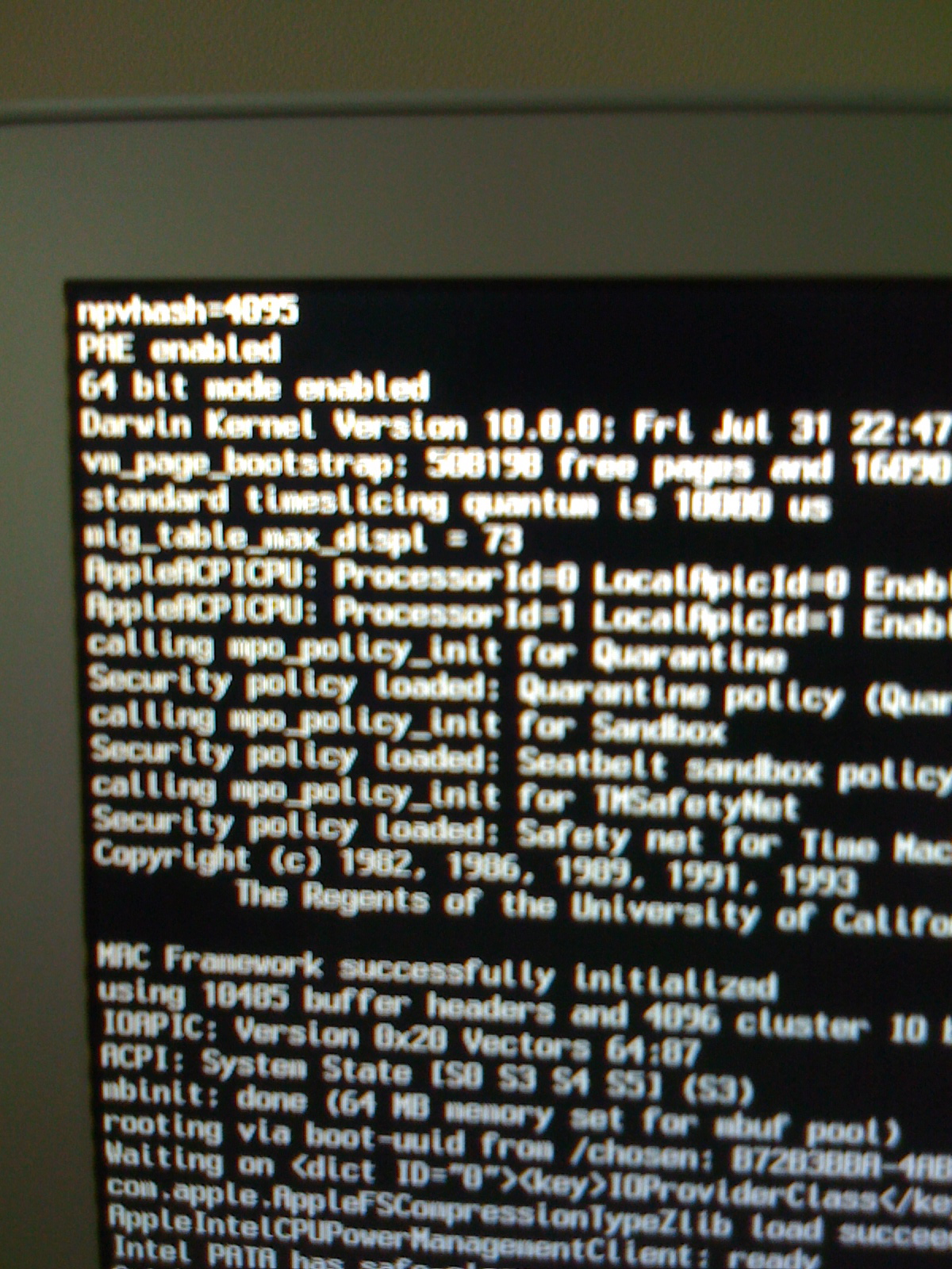

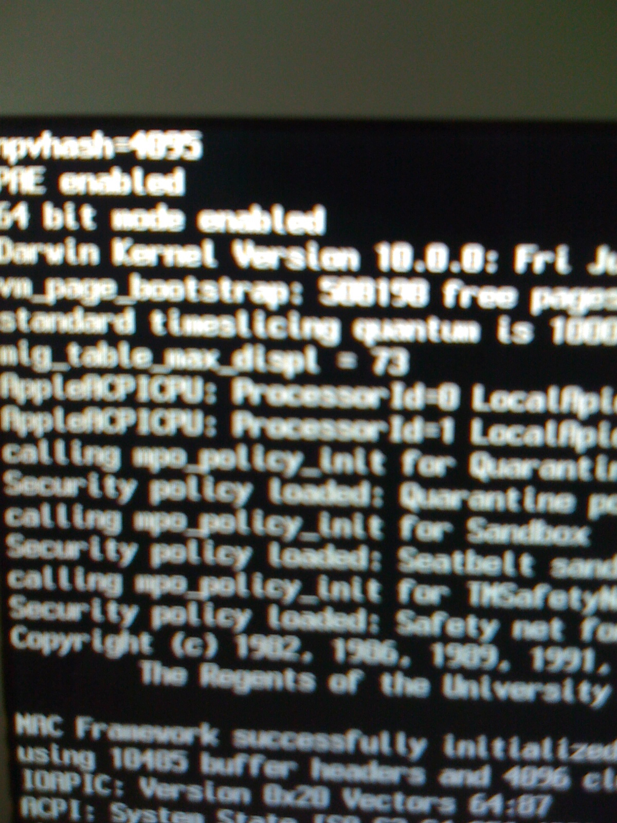

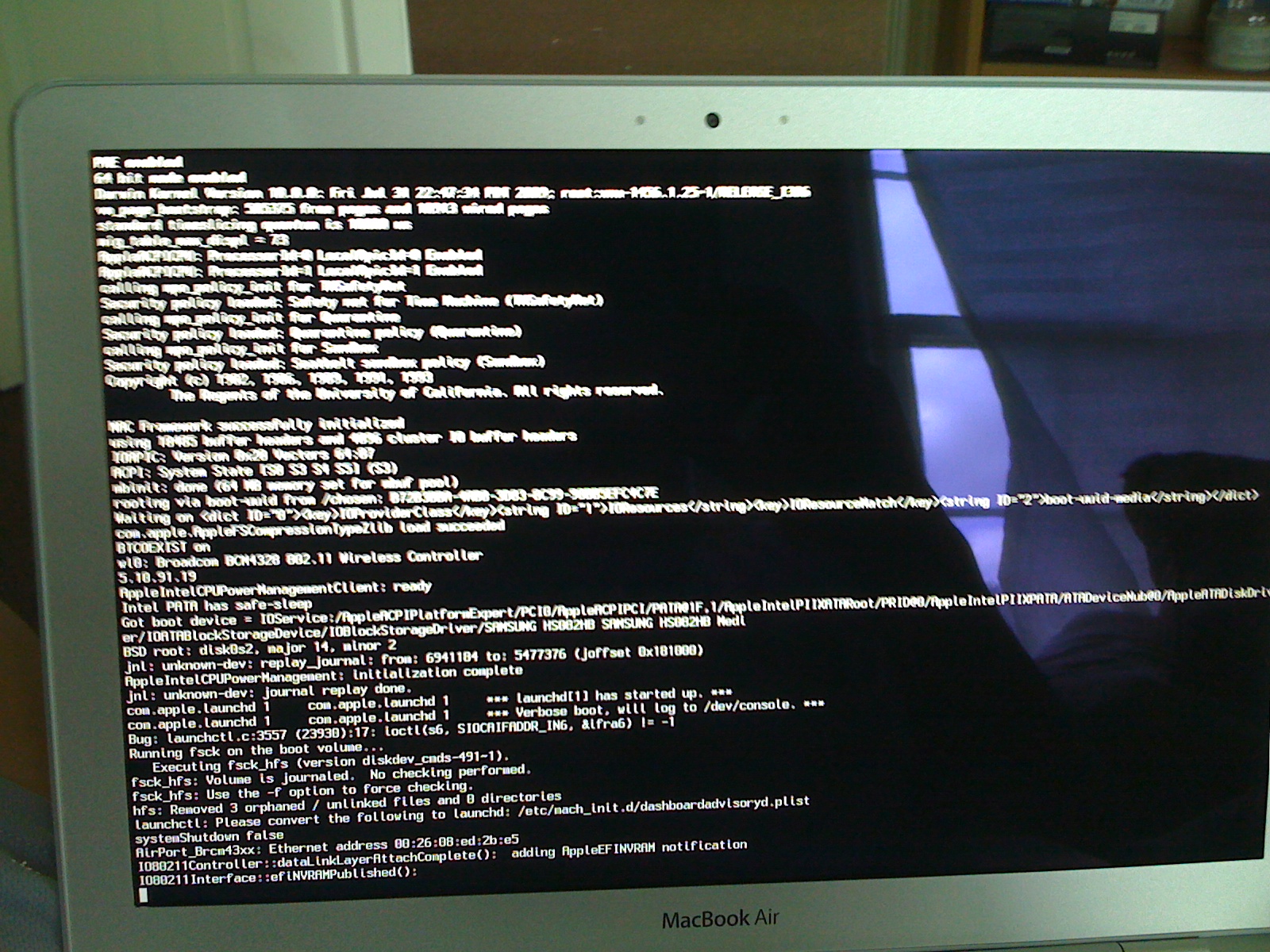

Hey everyone...I had a problem recently where my bezel was falling off and I had problems with keyboard itself. My Applecare more than covered everything and I suspect they may have even given me a refurb Rev. A as a replacement. I am updated to 10.6.1 but everytime the computer restarts I get this weird black screen instead of the standard grey, I was just curious if someone could elucidate what is going on thanks!

That kind of looks like you are booting in verbose mode rather as that looks like standard kernel boot messages that are normally hidden.
The machine properly boots, etc. Correct?
What is the output from:
sysctl kern.bootargs
I only have access to Leopard at the moment, but I imagine this would be were a permanent verbose/debug type argument would be stored.
yeah it makes the standard chime and boots to a grey screen which then turns to black and it seems to go through this debug process that freaks out if an external hard drive is connected, but even if an external is not connected it still goes through this process. Obviously it only affects the computer on startup but is there cause for concern any reason i should restore to get rid of it?

The -v for kern.bootargs is what's causing the behavior. The only question is where is that getting pulled from? Most likely either:
/etc/sysctl.conf
or
/Library/Preferences/SystemConfiguration/com.apple.Boot.plist
I don't think just running /usr/sbin/sysctl -w kern.bootargs="" will help as that is likely being read in on boot for it to be persistent across reboots. You will need to use a texteditor to change these files along with sudo.
Depending on your comfort level with being on the cutting edge, running 64 bit mode does have the potential to cause issues with third party kernel extensions (which are more likely to be 32-bit) like VPN software, etc. To revert to 32 bit mode, run
sudo systemsetup -setkernelbootarchitecture i386
or edit com.apple.Boot.plist (above) with a text editor and change arch=x86_64 to arch=i386.
