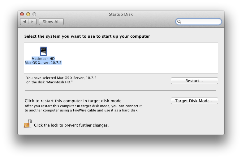

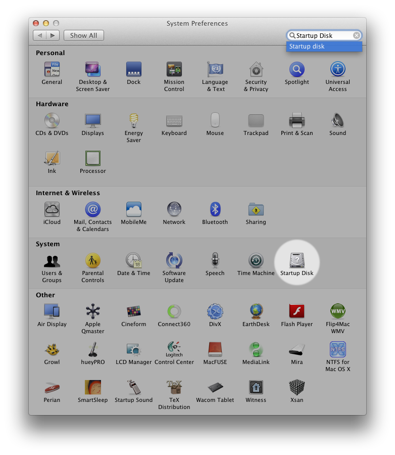

Go to :apple:—>System Preferences—>Startup Disk
Choose the system partition you want to automatically reboot into and select "Restart". It should boot correctly now.
If you need a visual~
Click the little :apple: on the top left of your screen and select "System Preferences"
Click on "Startup Disk" (You do not have to search, I simply did it to help illustrate)
Choose the startup volume you want to use. Yours would be the OS X partition you just installed.
Click on "Restart…" and it should ask for a password (if you have one—if you don't just continue) to continue. It should now reboot correctly.
Now in case you're wondering, the reason it would give you the folder icon with a question mark is previous to this procedure, the computer is searching for the old boot disk on startup and which it cannot find since you replaced the disk with another—it gives you an indication that the previous volume cannot be found (Folder with a question mark). This procedure tells the system there is a new boot volume.
