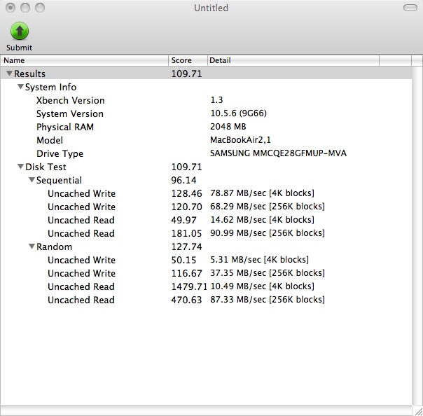

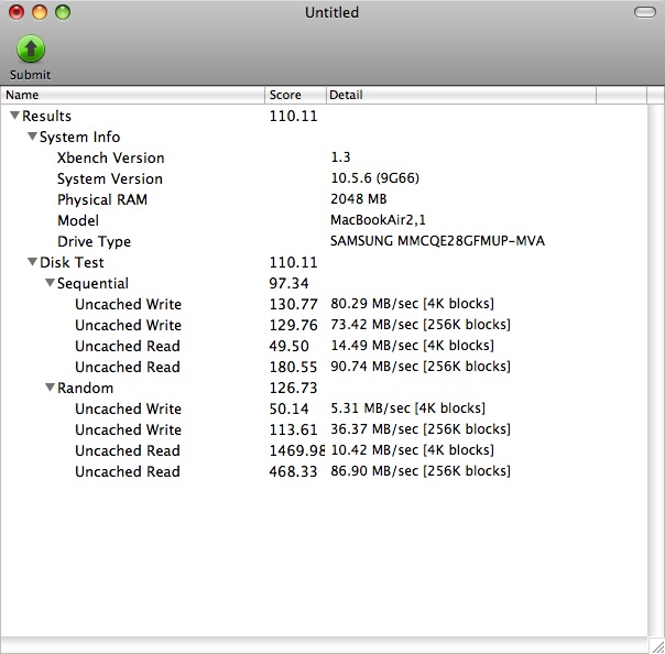

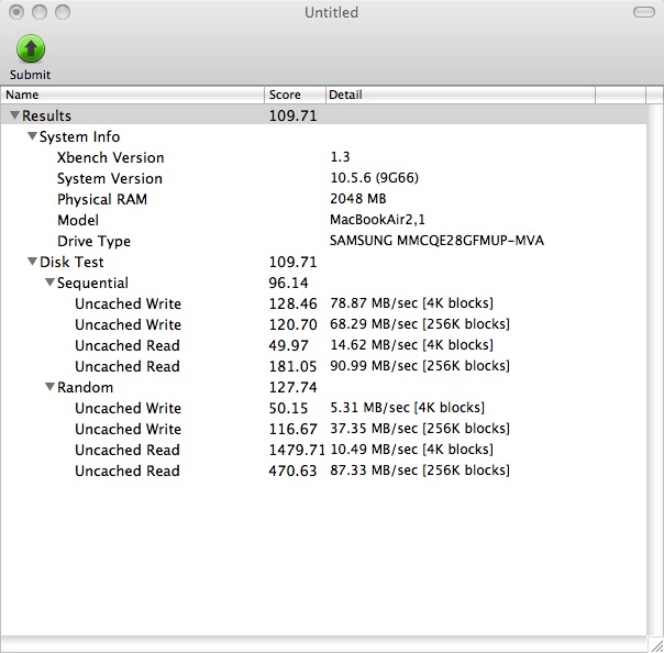

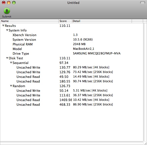

Xbench scores, two to show reproducibility (I think the 4k seq write is just to the cache.. dunno):

Well the speed difference is quite remarkable 🙂 The fit is good and not too tight.
The pins on the cable are about 0.4mm *including* spacing. Test the connections and make sure your solder points are good..
It might be worth noticing that although this is probably the same ssd as apple ships with, the writes on my mod are about double of that of the apple originals. Maybe this is firmware optimization related?
I wondered about those write speeds. Much better than mine. So you went from 120 GB HDD to 128 GB SSD? Couldn't remember..

Also note, the write speeds for the OP's tricked out version is double the standard SSD in the MBA.

So far, smooth sailing 🙂 It really is a great difference compared to the 120gb hdd... Regarding the size of the new ssd, it is 1.8", 3.5mm thick and 79 mm long. It is a Samsung 128gb 1.8" slim ssd, as seen on www.samsungssd.com . The drive is traded a lot on ebay and can be had for as low as 168ukp (~230usd) including shipping, at least in europe.
