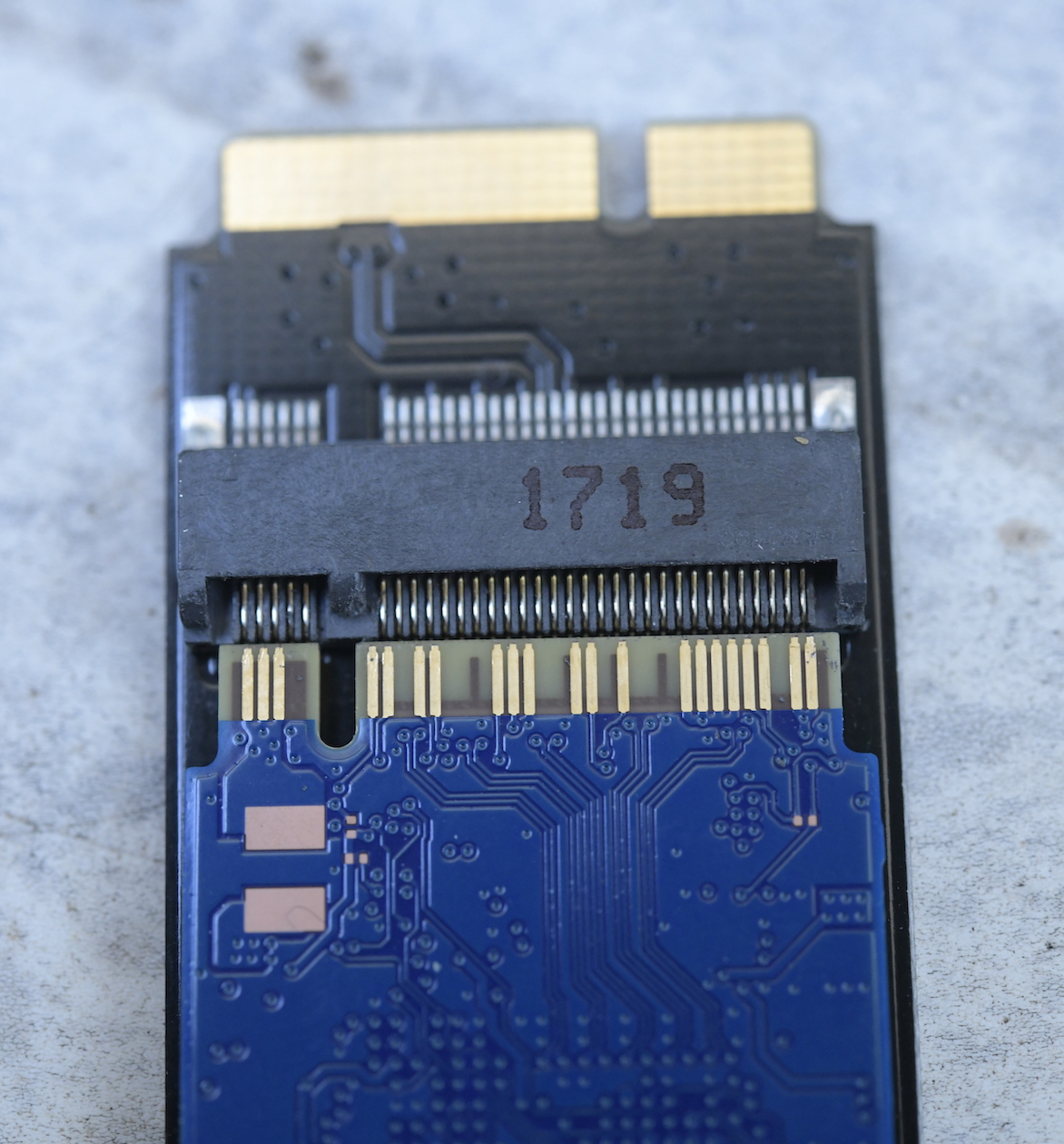

I guess the NMVE is not supposed to sit into the adapter I bought, I did fit it in but the computer won't start up, removed and it did start, mounted it again but again no startup; to add insult to injury two screws got locked, removed thanks to a friend and put back in the original (corrupted) SSD and computer won't start at all, removed and still no startup sound, did I brick the computer???
I finally got the Sintech adapter to fit into my 2012 11" MBAir but to my surprise the Kingston NMVE SSD won't fit, seems like a matter of a hair but the edges of the SSD won't slide into the adapter, might be my sight not that good any longer or wrong attempt at installing it but can't manage, would really appreciate somebody's help onto this to tell me if wrong combo of adapter vs SSD or whatever else.
See attached picture please

Couldn't go any worse, I used a nails file to fit thin the SSD as to fit into the adapter, slide it into the MBA and try and switch it on, no success, it needs the bottom panel to short the pins on the motherboard to power on but, still, no success, remove the adapter+SSD and it starts, mount it again, screw just three screws to keep the bottom in place but again no startup, try and remove the screws but the cheap screwdriver ruined the screws head and two of them are locked in, end of the day can't remove the screws which means no startup and adapter+SSD locked in and dunno how to remove the screws :-(

I got the WD Blue SSD which sits in the Sintech adapter and when booting with either Internet Recovery or from USB it shows into Disk Utility but fails to either partition or format, I get a (-69826) output error, don't know what to do now...
Any suggestion?
edit: removed the adapter, added a piece of masking tape (I guess that's how the blue tape is called) to the SSD and slide it back into the socket, maybe the tape, maybe the adapter/ssd wasn't inserted correctly but Catalina (off of an USB memory) is installing, keeping fingers crossed.
