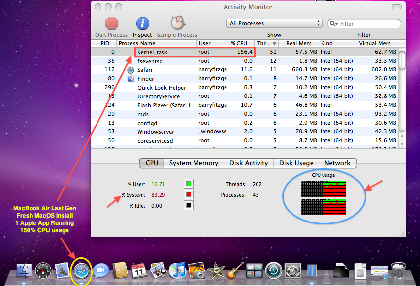

It took a massive google effort but I finally found a recent article quoting some internal sources from Apple. In any case, the way I read it was that the kernel_task process acts as some sort of under clocking mechanism to keep the Macbook Air cool or at a steady temperature. Anyhow, here's the article:
http://gogotechnology.blogspot.com/2009/07/macbook-air-and-kerneltask-apple-speaks.html
Apple Care and Kernel Task issue
I got my MacBook Air early August and and started trying to use it it hampered by this strange Kernal Task issue. At the request of Apple Care I did multiple captures and complete re-instals of the OS including Snow Leopard when it came out. After the most recent delays I demanded a replacement.
After all, how could a computer, loaded with ONLY Apple OS, running ONLY Apple Safari, become virtually unusable? You type and it take 10s of seconds to appear. I can't be expected to be an adjunct of Tech Support unable to load my aps to use the computer lest it be a non-virgin.
Apple repair depot was UNABLE to find a hardware problem. I was told by Apple Care that in the end, engineering might say that this is NOT a malfunction at all???? And I just have to live with an unusable computer.
Finally, I argued my way to a replacement through Customer Care. I really hope it works because I think these are great machines when functioning.
I will post when I have the results of the new machine!
