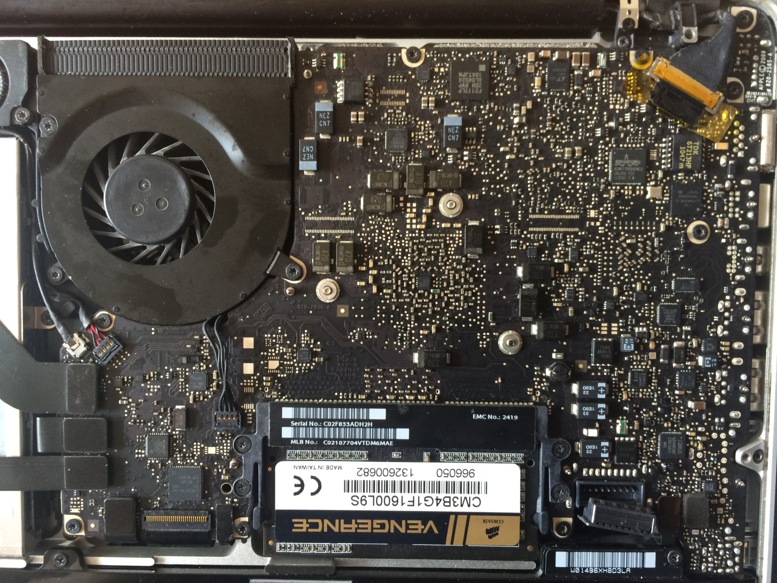

So I just replaced the SuperDrive with that HDD Sata III Adapter (with the HDD of course) and my MBP doesn´t turn on anymore.
Just a plain blackscreen, the fan does not work and there is no boot sound either.
I already tried to unplug the battery for a several hours and plug it back in. Nothing.
Tried to start with the magsafe and unplugged battery. Nothing.
Also tried a SMC Bypass. The fan is working but nothing else is.
The magsafe lights up in green when I plug it in. With or without connecting the battery.
Although the MBP (13" Early 2011) doesn´t start up I hear a little noise when I´m upclose with my ear on the MBP whenever I press the power button.
Also I should mention that I connected an usb-stick before the first boot after I finished the SuperDrive replacement.
On the first boot (not a SMC Bypass) the fan worked but the screen was black.
Hope that anyone can help me.

Can´t seem to find anything here. Battery is unplugged on purpose.
I already tried: SuperDrive + SSD, HDD + SSD, Superdrive + HDD, SuperDrive + Nothing
Edit: Found out that the little noise comes from the SSD (SuperDrive + SSD constellation).
When I take the SSD out and press the power button I hear only hear a tiny click or crack.

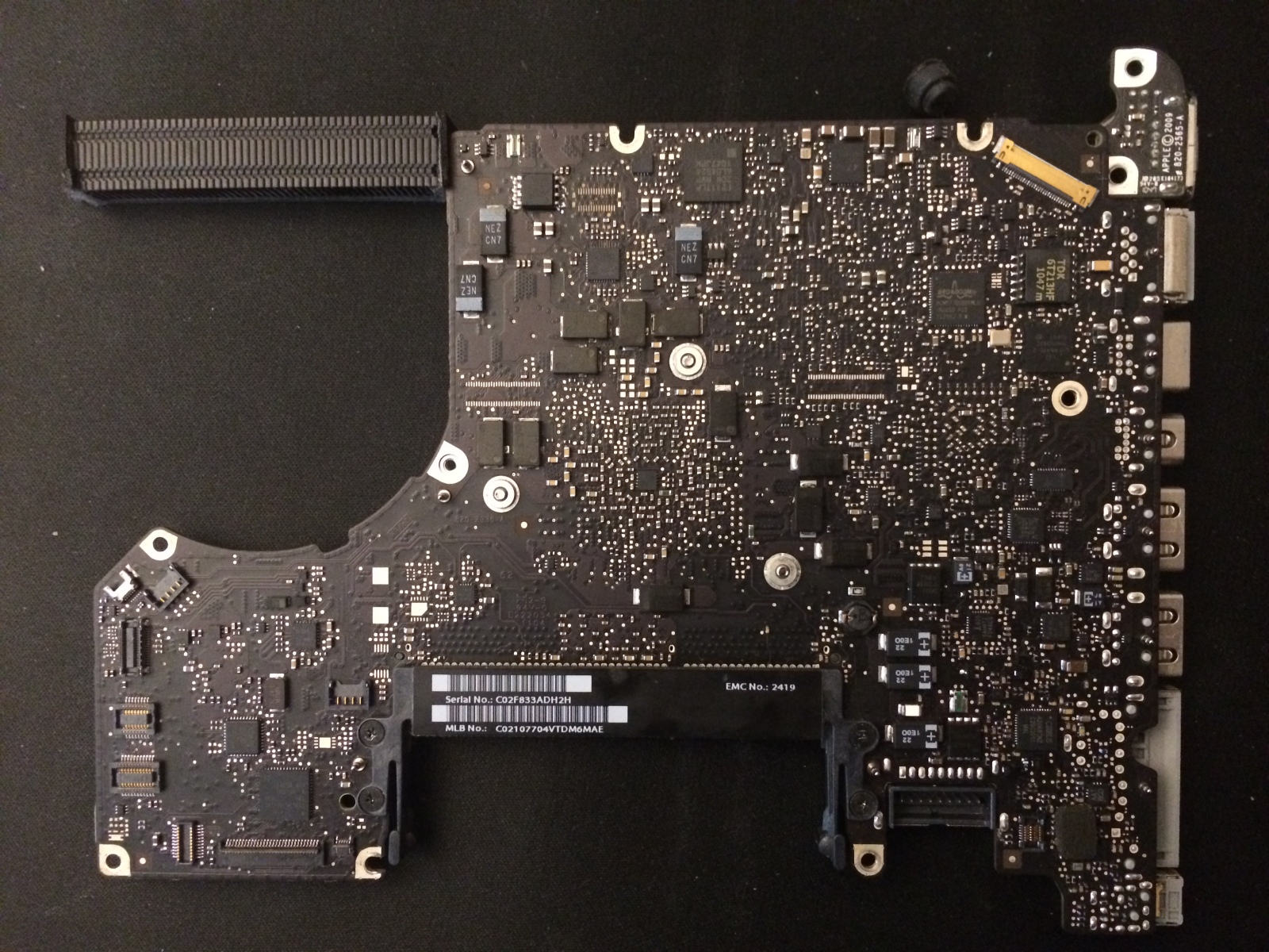

So, out of curiosity and mainly despair I removed the logic board and looked on the back of it to see, if there are any burned or suspicious areas.
Maybe one of you sees anything...

its possible you didn't take the correct ESD precautions when working on your mac and you've given the logic board a static shock, causing it to fail, did you wear a grounded wrist band ?
I will do the replacement process tomorrow again and try to do it very neatly and correct.
@dannylillhtc In fact I did not take these ESD precautions hence I did not wear a grounded wrist band.
What if I DID give the logicboard a static shock ? Would it be totally damaged ?
I'm no expert in these things i just normally take the precautions due to good habits, its possible you could have damaged a component that is critical to the booting of the system, I'm not sure to be honest
sadly a number of things could have happened, with ESD being the most likely. even a faulty SSD adapter might have shorted something.
No way to fix it if it actually happened ? Well other than buying a new logic board of course...
the best thing to do now is just connect the display cable, the keyboard cable, the fan and the memory and see if it fires up. Then one at a time connect everything else if it did fire up. This way you know that the board is faulty.
Sounds to me like the motherboard may have been fried, this could be from ESD or the drive adapter you fitted as I have come across devices that have the potential for causing power surges.
