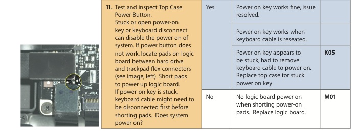

Any way you could post a picture of the two terminals? The one in the video is slightly different than mine and i've looked everywhere.

Here's how you can test that. Open te backplate and unplug the keyboard ribbon cable from the logic board. Next to that cable there should be two shorting pads with a power symbol next to them. If you don't see that symbol, use the ground post of one of the screws and the fifth pin from the left on the ribbon connector on the logic board. The pin you need to touch is usually labeled with a small hole or circle under it. I know it may sound confusing, but I'm not able to post a pic right now. This will pretty much tell you if it's the power button or the logic board as the keyboard and power button run through that same ribbon cable. Hope this helps!
Here ya go, straight from the source. Shh, don't tell anyone. 🙂

I've seen a few threads about "jump starting" the laptop using the keyboard connector on the logic board.

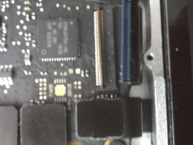

My logic board still looks a bit different from the picture so I want to make sure by posting a picture of mine. i don't want to be shorting random connections.
which two?? haha
Just an update, I found the power pads and it WORKED!!!
