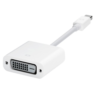

Thanks guys, that actually might be the issue. Im using this one right now
I've got it from a friend so i don't know if it is from apple or not but i do think so because it's exactly the same. It is a DVI Dual Link though. You mention to avoid apple, why so? (pure curiosity)

Apple Mini DisplayPort to DVI Adapter
MB570_AV1
Apple Mini DisplayPort to Dual-Link DVI Adapter
MB571_AV1
You seem to have a normal MDP to DVI adapter, not a Dual Link DVI adapter.

Okay, yesterday i went to an apple store an bought the mini displayport to DVI dual-link adapter (payd $99 for it but i didn't care about the price, just wanted it to work). I came home and everything worked perfectly.
A shame that applestore's hire such employees but however, i got it to work thanks to you guys. Thanks for all the help, appreciate it!
