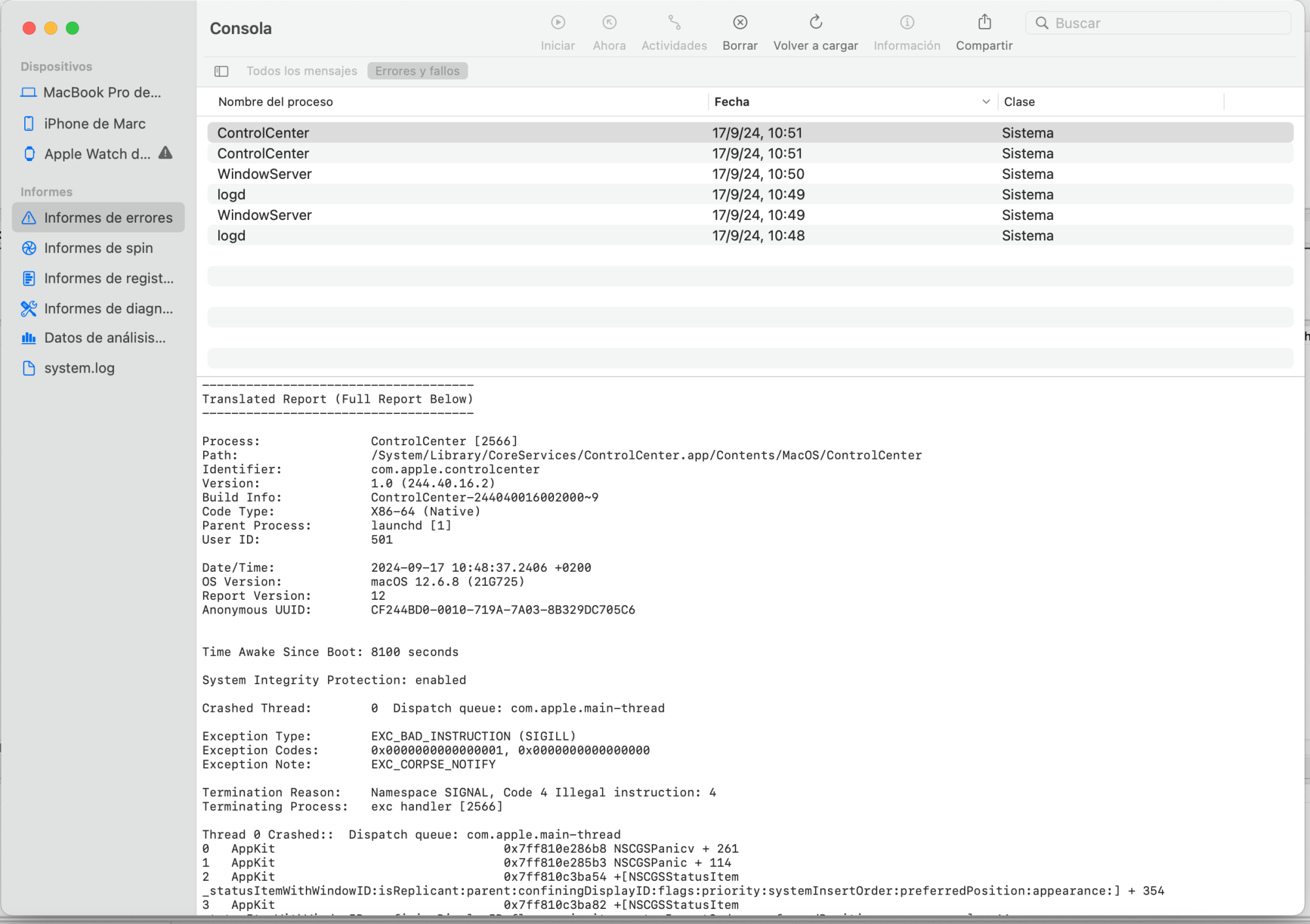

I saw that in the Console there are some logs in the minutes the last crash happend, something that i can check there?
