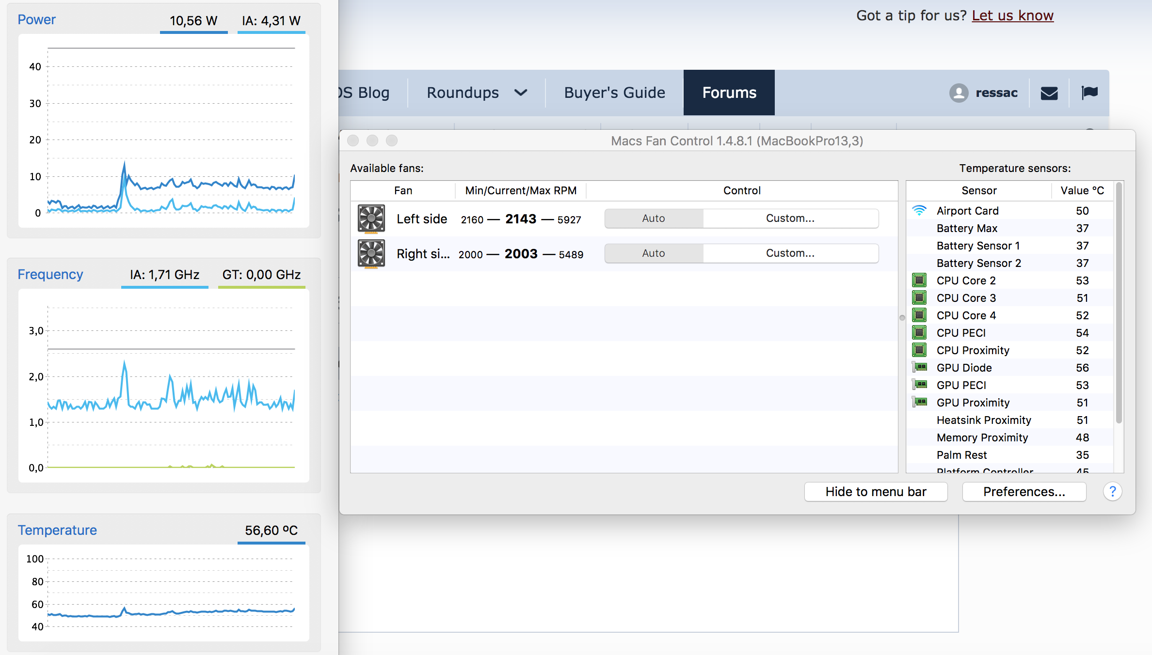

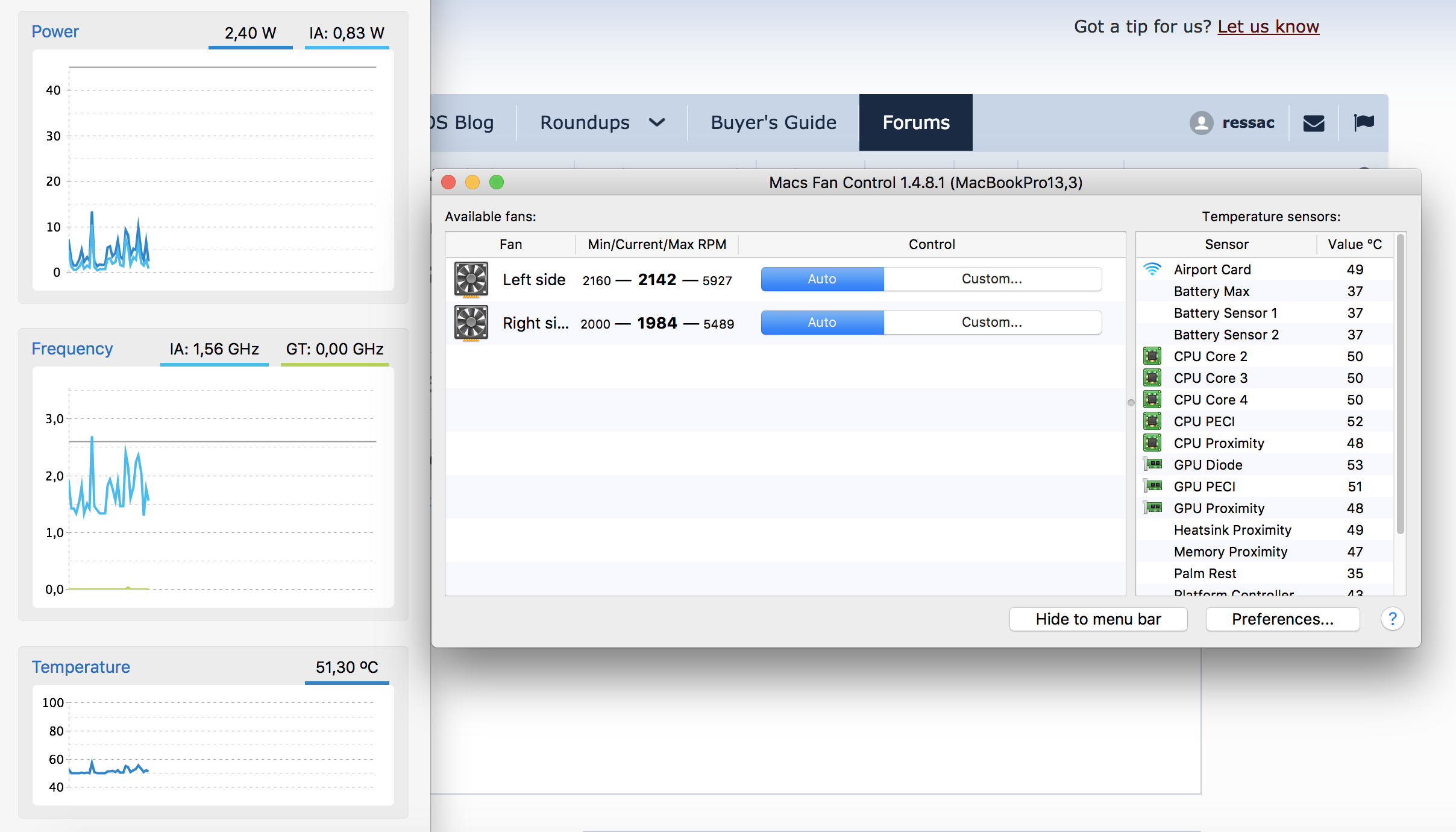

i attached two screenshots, you can see that after connecting external screen more power is used even if it's idle, because gpu is used

When you say it's a problem, is the computer crashing, experiencing shutdowns etc? Saying it gets 'warm' is not a problem in of itself, it's normal use for an electrical device to generate heat when drawing more wattage.
And looking at those screenshots, you're increasing the temperature by about 5'c, whilst drawing about 8w more power. Which adds up perfectly fine, the GPU is being used to provide the extra display, and is running about 2-3'c warmer than in idle. Fan wise again totally normal, things generate more heat and the fans increase to offset this and attempt to cool it down.
Best advice is to uninstall all these temperature/fan monitoring tools and just use the computer without worry, trust that Apple have spent millions making sure the thing won't melt, and if it does suddenly melt through the desk then take it to an Apple Store and have a chat about it.

As New Mac Smell says nothing here is abnormal, using an external screen uses the GPU because the video output is connected through the dGPU in the 15 inch machines.
This will use more power and generate a little heat, very little according to your screenshots.
Your mac is rated to shut down when the CPU/GPU reach 105 degrees centigrade to protect your computer but running at full tilt it will run for hours at 95-100 with no real adverse effects its a computer it generates heat and has cooling systems and fail-safes built in to protect it.
Due to the metal chassis this acts as a heat sink but does also make the surface warm to the touch sometimes its a trade off for chassis materials, as long as its not uncomfortable I don't see an issue. If its not what you want buy a plastic laptop that simple really.
