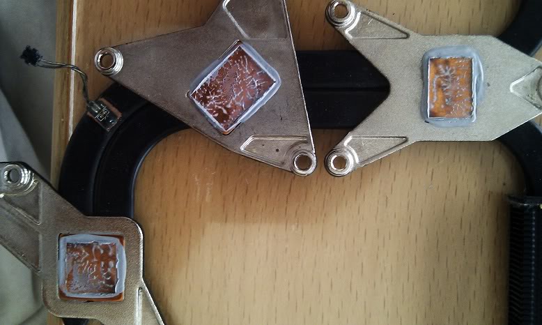

since its out of warranty anyways i opened it up again to see if i needed to re-reapply paste, heres what i found, all the paste to the edges with barely any on the die or copper of the heatsink. (i reapplied it and now it still idles at 70ishC). looks like it just evaporated or dissipated!
any ideas? its arctic mx2

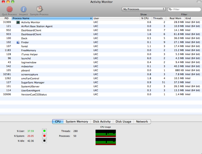

i dont see anything too out of the ordinary on activity monitor. do you guys?
yea nothings really using up too much. maybe launchd which goes from 0.0 to 11.3 sometimes. everything else is at 0.x - max 7.0 of %cpu usage. kernel task has 64 threads though and is the highest usage at idle.

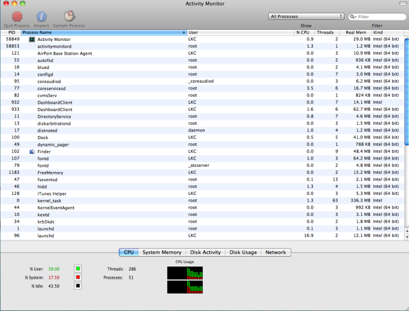

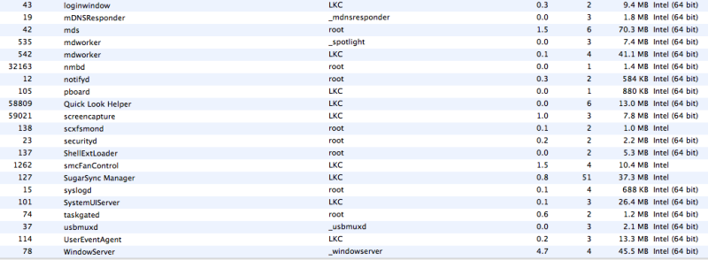

here is a screen shot currently. idling at 75C, no programs open (at least nothing i started). need 2 screenshots to get all of it in.
there are 3 programs that are "always on"
1. sugarsync (my cloud storage)
2. SMCfancontrol
3. freeMem
if you are right that your 08 mbp stays 95% idle, then mines a super busy bee. again ill give your suggestions a shot now and report back

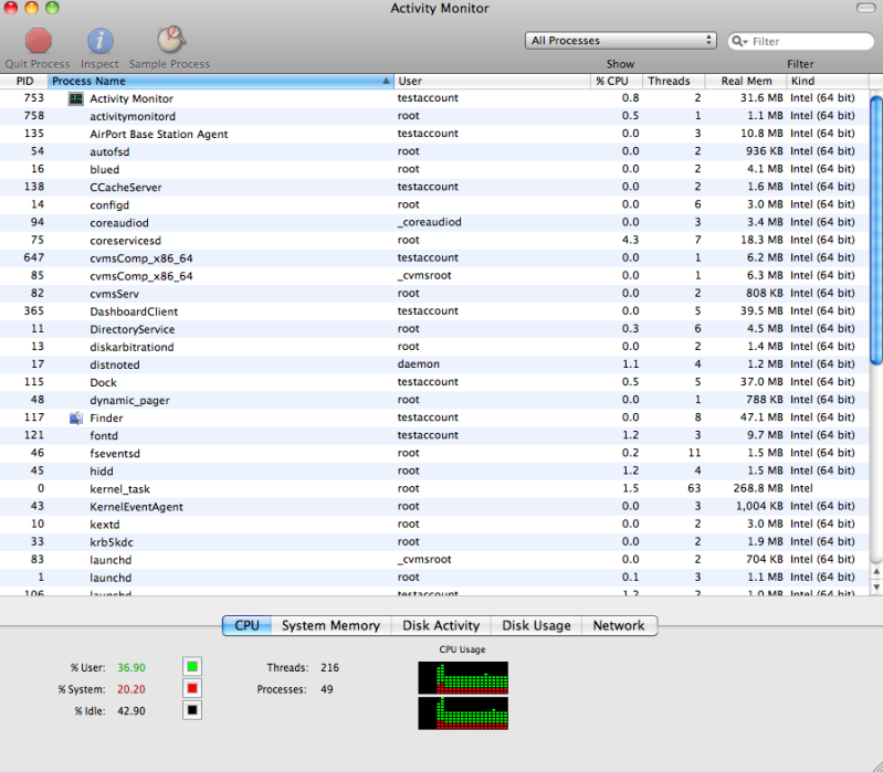

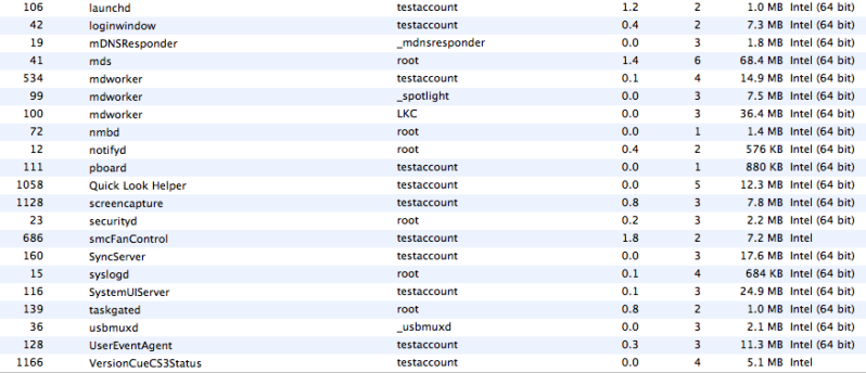

brand new user account doesnt seem to do much either. same temps too. now theres 3 launchd. i entered this account on a fresh restart of the comp (didnt just logout/login)
i think you may be onto something regarding system idle. i just asked my friend who has a quad i7 and his is at 98% idle too (even if mine is a veteran c2d).

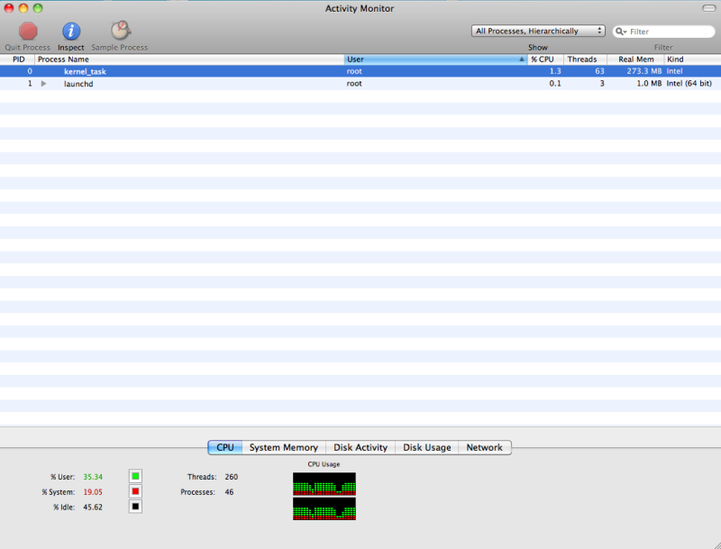

heres a non populated screen shot. if system idle is at 44% and launchd isnt doing much, nor is kernel, then what is?
How about sorting the activity monitor display by %CPU load?
Try to quit processes one at a time and see if that fixes the problem. Must be a software going rogue!
