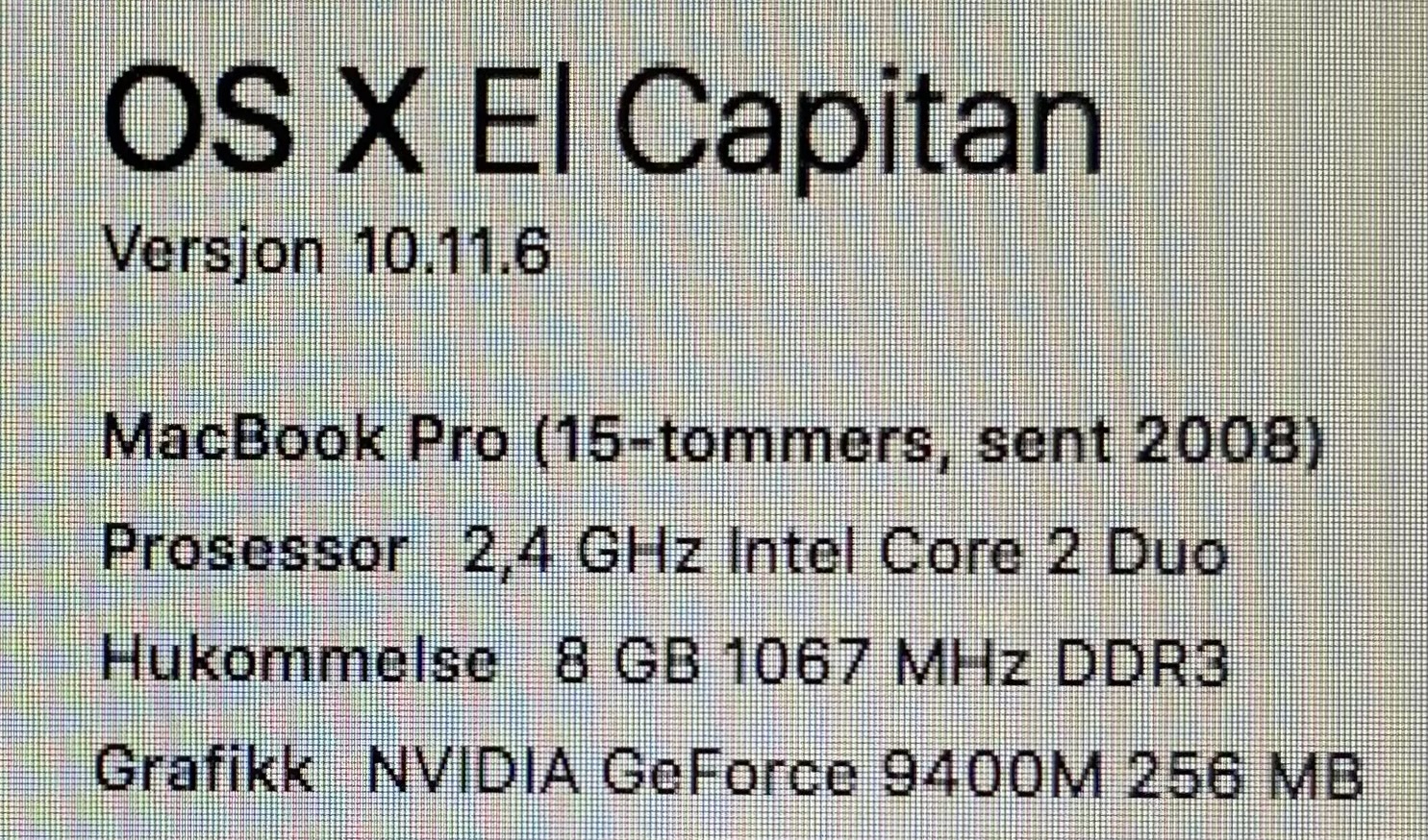

My wife has a very nice MBP 15" late-2008 2.4ghz that she purchased new. The MBP has 8gb RAM installed and runs El Capitan, otherwise everything is original hardware. These days she mostly uses the machine for watching YouTube videos, MS Word, connecting to OneDrive and general surfing (All banking and net-purchasing is done on a new iPhone 14).
The challenge with using the old MBP in 2023 is problems with certificates, for instanse when trying to connect to OneDrive via Safari. Some YouTube videos do not play well.
Apart from installing an SSD, what can be done to prolong the useful life of the late-2008 MBP?

The first thing to do is to look at the RAM slots. Do you see a green dot sticker?
If you do, your MacBook Pro is lucky enough to have had its original motherboard with the (notorious) Nvidia GeForce 8800m GPU replaced with a newer motherboard, with a revised GPU that will last a little longer. The revised GPU isn't a ticking time bomb like the original, but in my experience even these GPUs are prone to failure due to the heat envelope of the pre-unibody MacBook Pros.
To prolong the life of your Mac, changing the thermal compound and cleaning out the fans from dust buildup is an absolute must. On the software side, disable animations and transparency/translucency as much as possible across all of your apps and the OS (Accessibility in System Preferences is where you can disable these features in El Capitan).
YouTube can consume a lot of CPU resources and consequently lead to a lot of heat build up in your Mac, so you can try using browser extensions like h24ify, ViewTube, or the force 30 fps script in Tampermonkey to reduce the CPU/heat load from YouTube on your Mac.
If you don't see a green dot sticker, then your wife's MacBook Pro still has its original GPU, which was known for premature failures. Given its age and its unreliability, imminent failure is a certainty. Look into getting another cheap MacBook (like the MacBook 5,1, 5,2, 6,1 or 7,1) or a MacBook Pro that has either a GeForce 9400m or GeForce 320m GPU. Thankfully, transferring over should be as easy as just swapping the MacBook Pro's drive into the other Mac.

Thank you for providing interesting and valuable information! I will check out the things you suggest. It seems the MacBook Pro has the more recent GPU.

Ah, I misread your post and you indeed have the 2008 MacBook Pro which didn't have the awful GeForce 8800m. Huzzah! 🥳
If your wife isn't tied to any specific purchased or require software that needs OS X, what you could also do is install Linux on your Mac. You wouldn't even need to erase your existing install of OS X – you could just swap out your drive with OS X installed for a cheap SSD on which you could install Linux.
The main advantage is that you'd have access to up-to-date versions of Chrome and Firefox and LibreOffice, greatly extending the usable lifespan of your Mac. Installing Linux has basically made some of my older 2006 and 2007-era MacBooks (with upgrades) feel like they can now be usable daily drivers for basic tasks.

If the old Safari is the main problem with accessing sites, just install chromium-legacy, pale moon, or sealion web browsers which are all up to date. They will make the web capable again on El Capitan.
