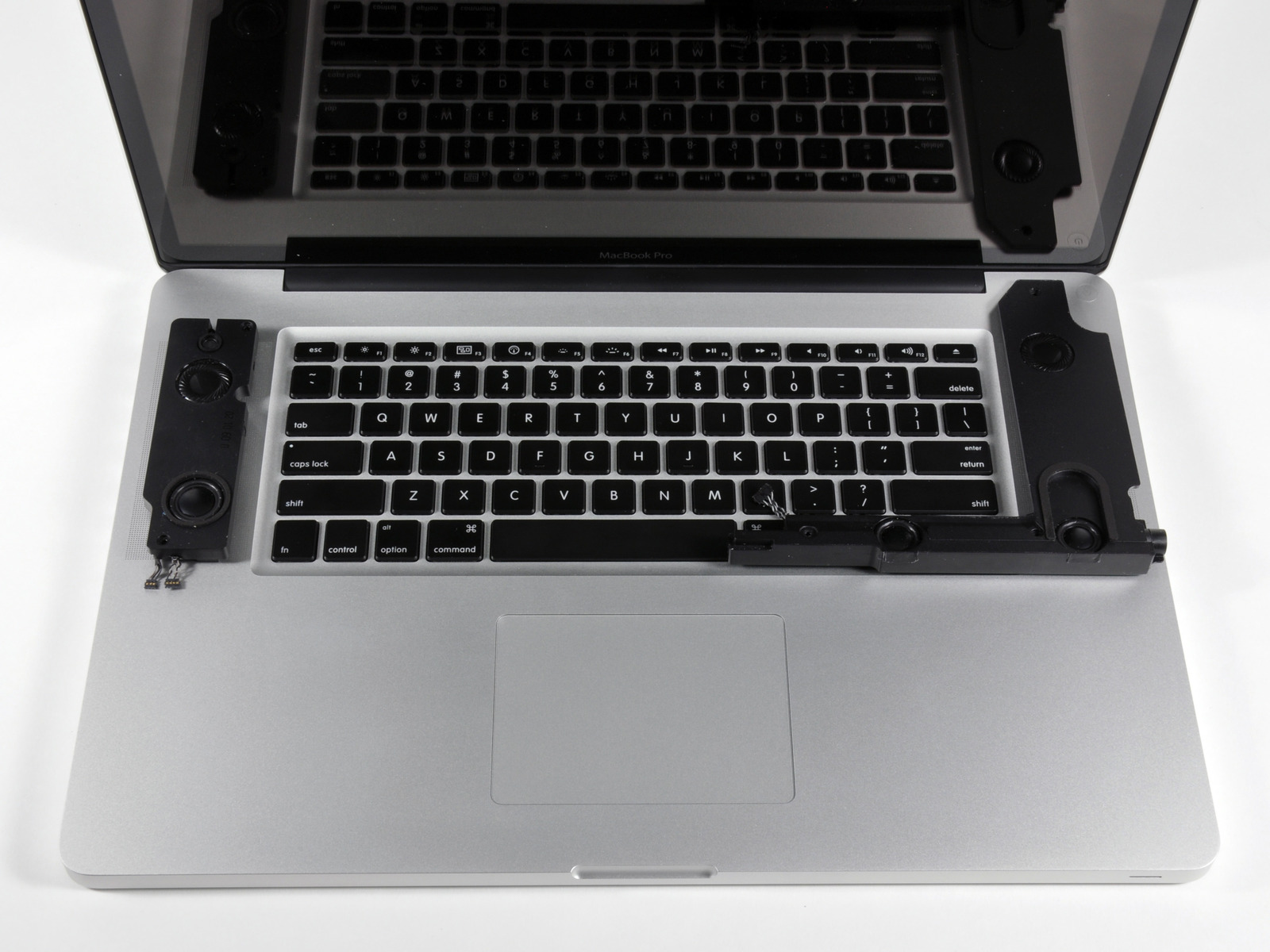

    The 17 inch has 4 speakers (2 on each side) while the 15 inch has 2 speakers (1 on each side). All speakers are exactly the same though.

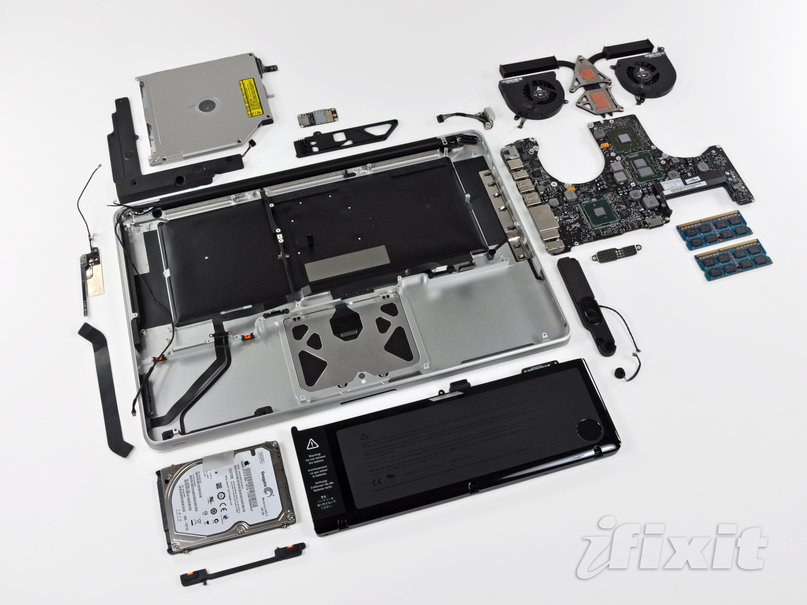

    17" has larger fans, so can probably run at higher clocks a bit longer than 15" before throttling down. iFix it has the pics you can see clear as day, 17" has sunons, 15" has something else.

    The speakers are bigger on the 17" model compared to the 15"
    Images from iFixit.com
    [​IMG]
    17"
    [​IMG]
    15"

    i hadnt realized how awesome a mac looks even with all its organs lying about.
