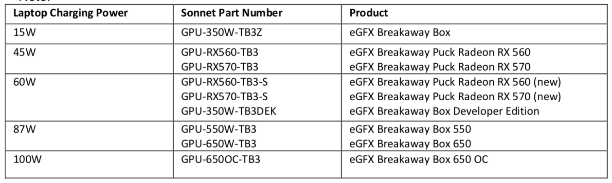

The Razer Core X and Core X Chroma are advertising 100W charging via USB-C. If you're also looking for an eGPU solution, these may be worth looking into.
The Sonnet eGFX is only 87W charging for the GPU-550W-TB3 model. The GPU-650WOC-TB3 model is advertising up to 100W charging. This might be a replacement or newer model because there are conflicts mentioning 87W in several places. This chart specifically shows 100W:

Technical note for the docks offering pass through. Most of them take ~15W for the device itself, then pass through the input minus ~15W. 100W input would result in 85W available for USB-C PD on the majority of those devices. Unless someone can find a USB-C charger that provides ~115W (do not believe they exist right now), these may not be better options than the current crop of ~85W-87W devices out there certified for 15" MBP 2019.
