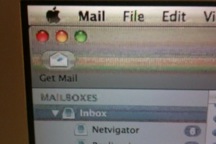

3. It began as a distorted band of pink and purple in anything dark. See image 'At first' attached.

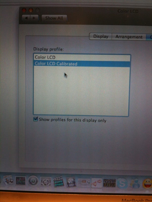

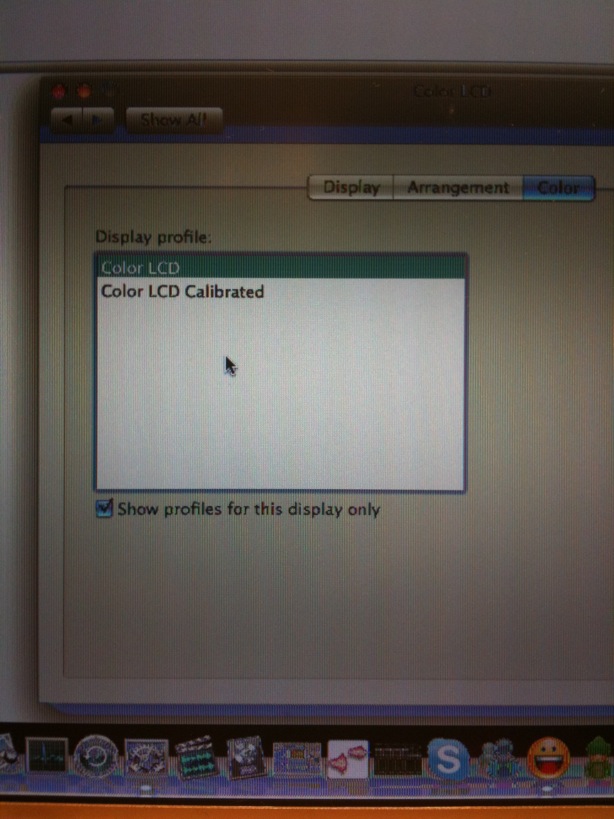

5. The dock is badly affected due to all the colors in the icons. I did a manual display calibration in expert mode. There are 5 steps to determine the display's native luminance response curves. The 4th and 5th cannot be effectively adjusted due to this problem. The calibration is somewhat able to partially mask the problem but certainly not fix it. See more images attached. You can see a blue line artifact at the bottom of the title bar and as a shadow under the window itself. The fine white lines are also there but hard to see.
