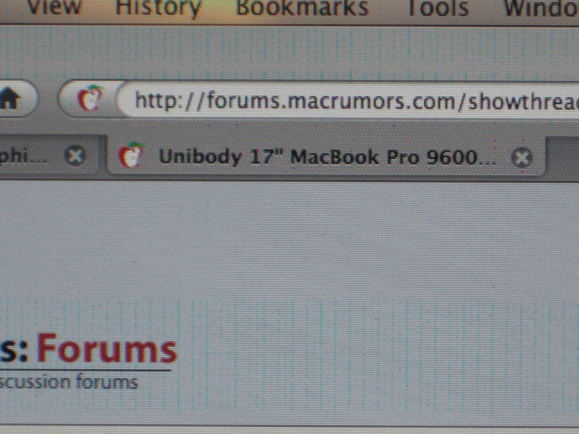

I had this problem as bad as anyone (see attached pic). I called apple this mornin at about 11am to start the replacement process, he said i could do that but that i had some time before i had to return it so we could do some troubleshooting first. He had me do a couple of resets and walla it fixed the problem. I'm sorry i dont remember them exactly but if you call them they should be able to talk you thru it, something with the ctrl +alt + power, and then one more that used a couple of letter keys as well. But let me assure you guys, i was getting the lines bad just from watching a video and just surfing the web, but now ive been testing it all mornin, and working my machine hard, for almost an hour i had 2 hd streams going and had WoW runnin in the background (dont play it, its just the only game in my house at the moment that i can test my gpu with hehe). Anyway I didnt see one line or artifact show up all afternoon and its been workin hard, so even if it comes back I think it would make sence that it is a software issue and not a hardware failure. Hope this helps out, good luck people.
All you did was an SMC and PRAM reset (remove battery, press and hold power button for 5 sec. (SMC) and CMD+option+P+R (PRAM)) and RARELY does that fix GPU problems. Like OP said, you're probably not seeing them anymore since the GPU temp. has decreased since you've reset your computer.

nevermind that reset that they had me do fixed it for about 12 hours. Its weird I worked my machine hard all day and then later when i booted and watched a vid it started all over again and is worse than ever, dont know what to think anymore. Oh well, back to the replacement idea i guess.
I was able to reproduce the GPU artifacts within minutes of playing 3 HD movie trailers simultaneously in QuickTime even though the CPU temp was less than 80 degrees C. I'm not sure what the GPU temp was. Resetting the PRAM didn't help, but resetting the SMC did.
After resetting the SMC, I played the same 3 HD movie trailers on loop for almost 8 hours, and even though the CPU temp was almost 100, the artifacts didn't appear. I even played a 4th HD clip for a while, which increased the CPU load even more, and still no artifacts.
I am having the same problem with my MBP 17in. So during the 8 hours did you ever restart the computer or let it go to sleep? If you haven't could you please try letting it go to sleep and then doing a couple restarts.
