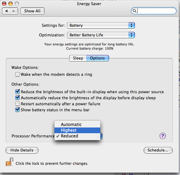

In system preferences go to Energy Saver and select the Battery option from the drop down list. Go to the Options tab and see what it says under "Processor Performance". By default when on batteries it is in "reduced" mode, so the battery lasts longer. Try setting it to highest if you want the absolute highest CPU performance constantly, or automatic for it to adapt more when needed.
Does this solve the problem your having?
I don't have a Core Duo so don't know how different the dual cores will act compared to a PB G4 1.5GHz.
