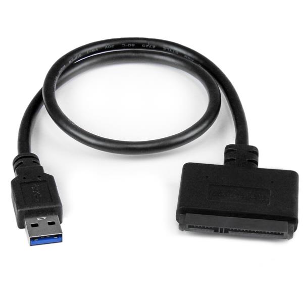

- I've read about at least one SATA-USB chipset that allows the passing of ATA commands such as TRIM. Perhaps worth looking into.
I have a couple of 3.0 enclosures that I have tried and I use one of these for migration USB 3.0 to SATA III).
None have given TRIM support. I haven't seen anyone write that they have had success in getting the commands passed on through UBS 3.0 or 3.1. I do not think it is possible. If it were, everyone would using that chipset and no one would be using those cheap Thunderbolt enclosures. There only reason why StoreJet and the like exist is to provide relatively inexpensive assess to TRIM. USB 3 is faster in most cases, until it the drive gets bogged down.
None have given TRIM support. I haven't seen anyone write that they have had success in getting the commands passed on through UBS 3.0 or 3.1. I do not think it is possible. If it were, everyone would using that chipset and no one would be using those cheap Thunderbolt enclosures. There only reason why to StoreJet, etc, exist is to provide relatively inexpensive assess to TRIM. USB 3 is faster in most cases, until it the drive slows down.
- Some quick Googling haven't yet led me to what I read a few months ago on it. But I'll see if I can dig it up.
I have done quite a bit of investigation over the past several months. There isn't a USB adapter that supports TRIM. If there was, everyone would be using it and it would be easily found.
- I was leaning toward that conclusion as well, and still am to a certain extent. It's a shame I didn't save it and can't remember in detail what it was. It might not even have been a product in existence but only a theoretical possibility.
I need to do some digging. Hang tight.
You are correct. USB cannot pass along the SATA TRIM command.
What some people have read and it has caused confusion, is some UASP (USB-attached SCSI protocol) enclosure chipsets can convert the SCSI Unmap command (similar to TRIM) to TRIM commands at the drive. Windows can run this SCSI Unmap command with the Powershell command Optimize-Volume and the -ReTrim option. OS X cannot run the SCSI Unmap command (at least not that I have been able to find). So at this point, no matter what chipset you use, you are not going to get TRIM over USB on a Mac.
There is some discussion at the bottom of this article.
- So what I'm reading is that TRIM is possible in a roundabout way, but that OS X can't do it currently in that roundabout way. Correct?
In your linked article, Anandtech claims that both reviewed enclosures have "no trouble supporting TRIM" (in that roundabout way).
Correct. The UASP controller converts the SCSI Unmap command to TRIM and Windows can do that (pass the Unmap command). I think that is what is happening in those two tests you linked, although they don't go into the under the hood workings like the article from Anandtech I mentioned.
- I'd guess so, too. So it is actually possible, which is pretty cool. Just not on the majority of SATA-USB chipsets and not yet in OS X.
Considering Apple's disregard for cool protocol standards (seriously, when are we going to get DisplayPort daisy-chaining?), it's probably a long way off, too.
I doubt it will ever happen. Apple wants everyone to buy internal SSDs at their own inflated prices.
