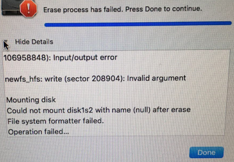

I just ran into a problem with my MBP 2011 and using a HDD via Data Doubler in the Optical Bay. I tried to format the drive and it always fails. Removing the drive and connecting it via USB works just fine. So the HDD itself is ok. Also, when I format the drive using USB, then put it back into the optical bay, I can use it, so I don't believe that the SATA cable is broken.
I did a bit of research and the most suggestions are around a broken HDD or cable but that doesn't seem to be the case here.
Any other suggestions or can somebody confirm that this is just a limitation of MacOS and the optical SATA port? (I'm using the latest OSX with all available updates installed)
See error screenshot
Thanks for your help

Which hard drive specifically? 2011 machines have been known to have issues with SATA III drives in the optical bay.
My late 2011 15" MBP - as with most same MBPs - do not work with SATA III drives in optical bay. Only SATA II.
I remember reading that all data doublers are NOT the same, and might be not-quite-compatible with the firmware on some drives.
Likely a simpler idea to try a different data doubler - but, the optical bay may just the issue, as suggested, and won't down clock an SATA III drive.
