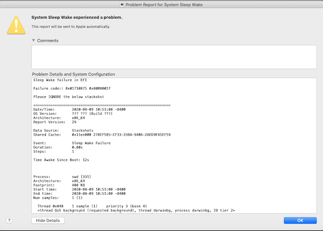

My battery drains over a day or two when my 2012 (non-retina) MBP is closed and suspended. If the battery dies, it crashes when it wakes back up. I've tried a new SSD, went back to stock ram, reset NVRAM and SMC, reinstalled a couple times. It's 100% stable in every other situation and sleeps/wakes under other circumstances; when plugged in, if I wake it before the battery dies. Could it be my battery? Coconut shows it as good.

Late update. It's a Catalina problem.
I don't know what's causing it, but I downgraded to Mojave and everything is fixed. I reinstalled on a freshly formatted drive with Catalina and the problem comes right back....
No idea where to go from here except to hang out on Mojave, which I'm doing for now. Maybe the patched Big Sur version that people on this forum are working on will fix it...maybe not..Clearly it's a Catalina bug and no amount of reporting it to Apple does anything.
