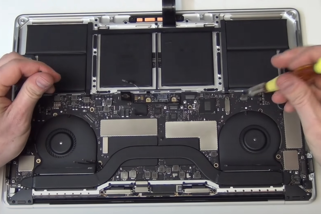

but which of the screen flat cable is responsible for this type of problem? if I know which one I can order a replacement and jumper it.
If there are two separate ribbon cables-- usually one will be for the screen backlight, and the other would be the video data cable.
Not likely to be backlight, so it would be the other cable. (sorry, I don't have any other information about which is which)
I could be wrong, but I don't think the cables are available separately. If you have a source, then get the whole set of cables (probably not that expensive, and you would have both, in case the part that runs through the hinge has damaged both cables, such as that visible in the repair video that Sanpete posted in post #4
flexgate is more often a backlight issue (screen goes black), but your issue could be the same fix, which can be the flex cable(s) that connects the display to the logic board. If that does not fix the issue, then it is likely the graphics chip (and replacing the logic board)

the screen now is completely blank when fully opened. If I close the lid and open it just a few degrees then I can see a full and correct picture. A few degrees more and a blank screen. I know the backlight works as I can see the faint light although no picture. Which one of the flat cables is responsible for the picture (and not backlight)?
I believe both are, if I remember correctly all the wider flex cables are for data. The one on the left is for the left side of the screen, and the right is for the right side. The other cable that looks like backlight is for the camera. Normally what causes this issue is sand or dust particles getting in the way of the cables and over time they rub and the insulation wears off.
