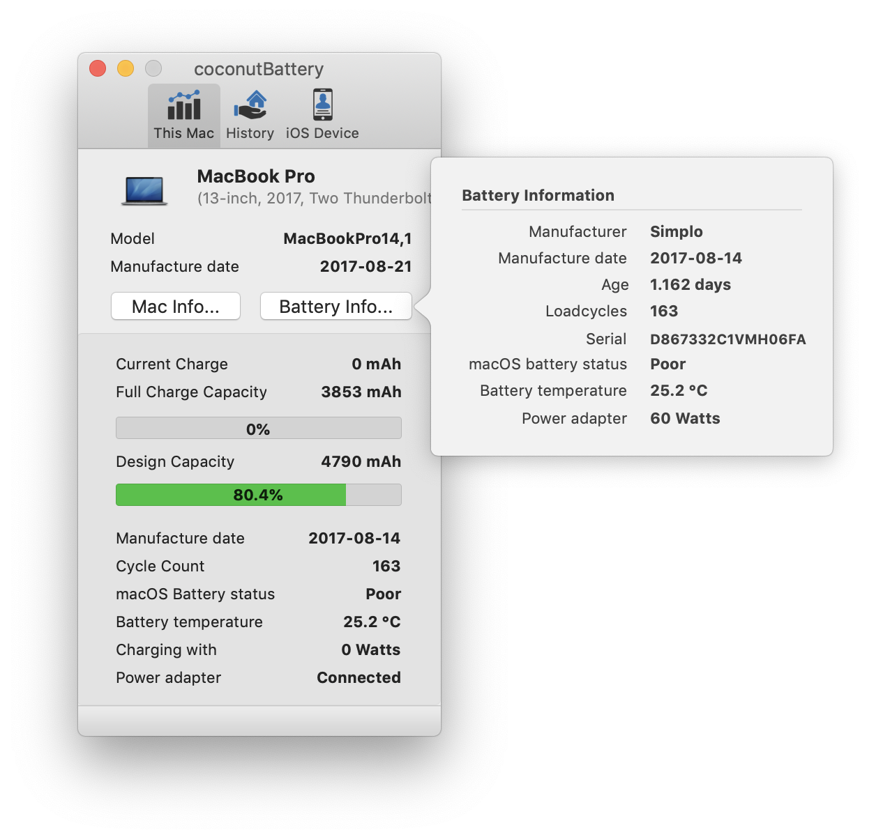

Tonight I took the Macbook to watch some movies, but it won't react when typing any keys. It's obviously turned off. Pressing power button - nothing happens. Since it was on charger, I expect the battery to be fully charged, but obviously it isn't.
After reconnecting the charger and pressing the power button multiple times, the machine turned on and I was able to boot. The battery icon displays "Service battery" and "Battery Is Not Charging", even with the power adapter connected. Pulling it will power off the machine immediately. Tried SMC reset several times, without luck. According to coconutBattery I have 163 cycles and the battery is 3 years old. Is it normal to have a (entirely) dead battery after such period of time on a MBP?
While I made an appointment to get this fixed, I'm still curious if its really the battery (since it has 80% capacity left) or something else because it simply doesn't even try to charge the battery at all.

Reinstalling macOS did not help, which was expected. Genius Bar has diagnosed a dead battery and will send it in for repair.
Update: Got the machine back from repair. They replaced the battery, top case and display assembly. Feels like a new machine.
