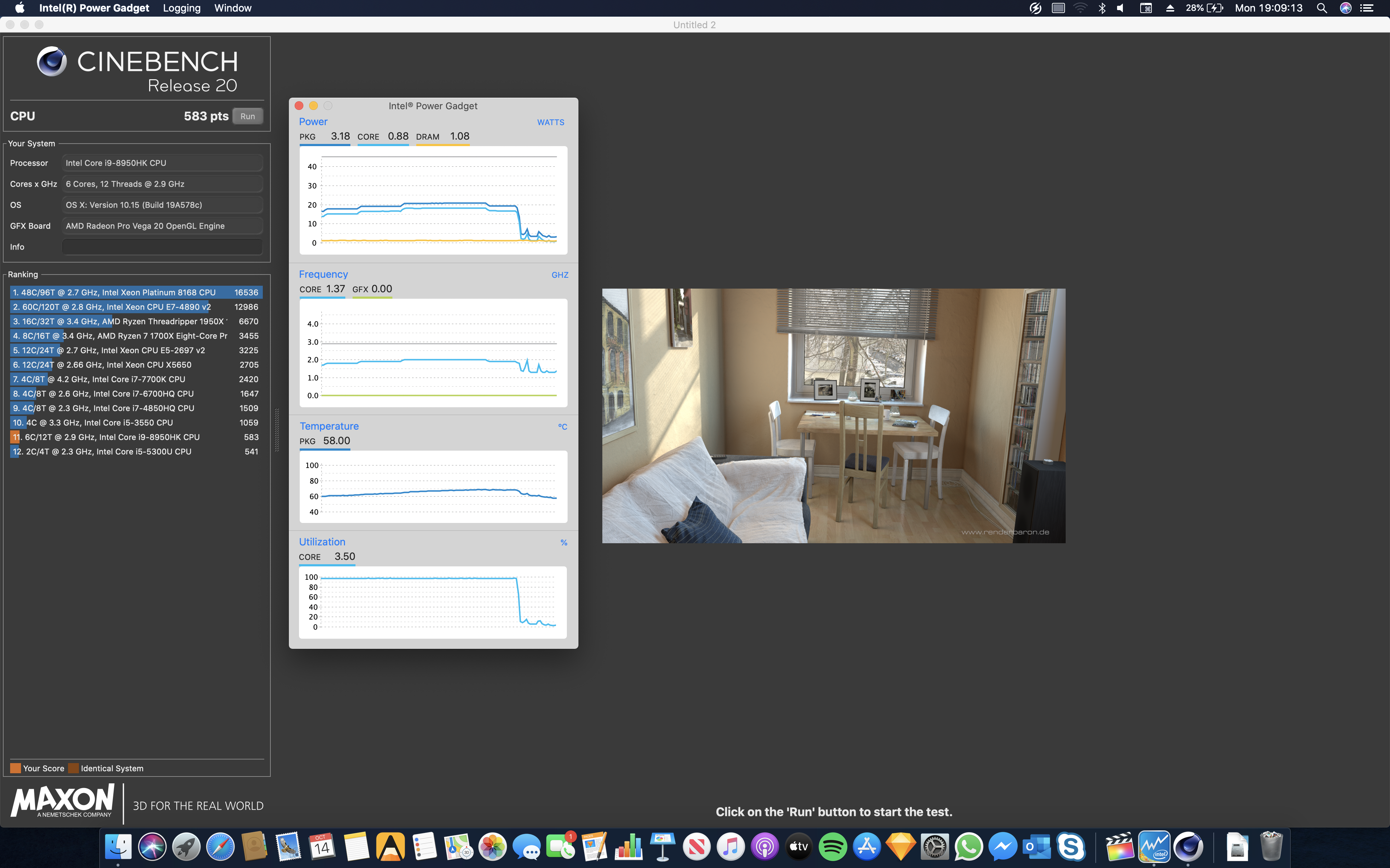

Here is a picture of a Cinebench runtime only getting 583pts which seems super low and it never goes up to the base clock speed. Is this how it should be running?
I would say that your clocks are abnormally low. You should be seeing around 3Ghz sustained while running Cinebench. Since your temperature is never above 70C and your CPU power usage tops out at 20W I'd say that you have a problem with your power management system.
Should be much higher. Even my entry model MBP 13 2019 gives well over 1600pts.

I have tried a fresh install, SMC reset etc. Nothing installed to limit TDP either. It looks like it is going back to technical support. Possibly with the Cinebench screenshot to show them, hopefully I'll get a different result this time.
You can say something along the lines of "My CPU has the TDP of 45W and yet it does not hit in in a sustained workload that occupies 100% of CPU, so it does not meet the advertised spec". And if the person you are talking to seems not to understand what you just said, demand to talk to a technician 😉
