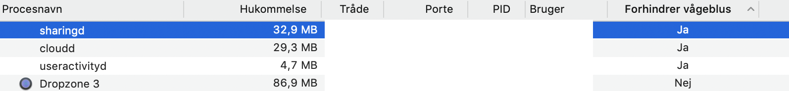

I took a look in the Activity monitor and sorted by "prevent sleep" and I found these 3. They seem to constantly switch between Yes and No in the "prevent sleep" column. Could they be what causes my Mac to lose so my battery, and if so, what should I do about them?
Thanks again! I really appreciate it

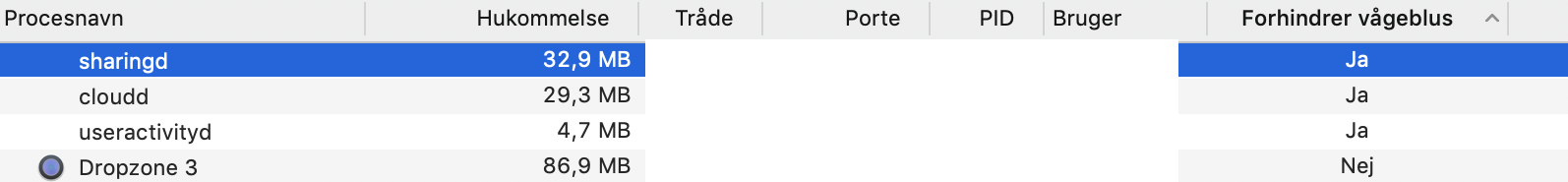

Well,
these are deamons - applications which are suppose to run always and are restarted in they are killed (I think). Both relate to cloud or sharing of documents. Both on my system are mostly "not" blocking sleep.
I wonder if there is some problem with iCloud syncing and system is trying to sort this out. That would prevent system from sleep as it is working on this.
I would log out of iCloud on this computer and log back in. Make sure you have backup of your documents in iCloud before you do this as it is not clear what happens and which documents are going to be left after sync.
Google may provide more information on what to do, even Apple may have instructions.
