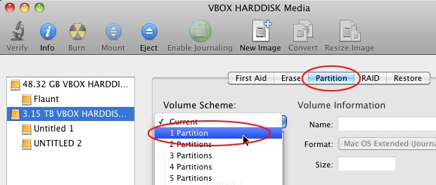

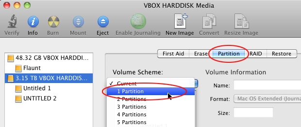

The issue in your case is that the hard drive is heavily fragmented and thus cannot be repartitioned since there isn't enough free disk space. There are two ways to solve it:
1) Get a copy of iDefrag (costs something like $20) and run it on your HDD.
2) Backup your HDD to an external HD by using either the time machine or carbon copy cloner, boot your mac with the 10.6 osx disk and run the disk utility to delete your OSX partition, create a new hfs+ partition and restore your backup into it.
Many people going to the trouble to move data off their hard drive, just erase the existing partition, rather than choosing the Partition tab and also changing the scheme from Current to 1 Partition. They should do the latter.
