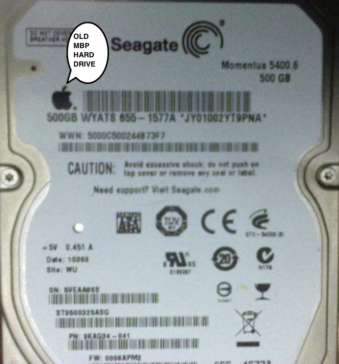

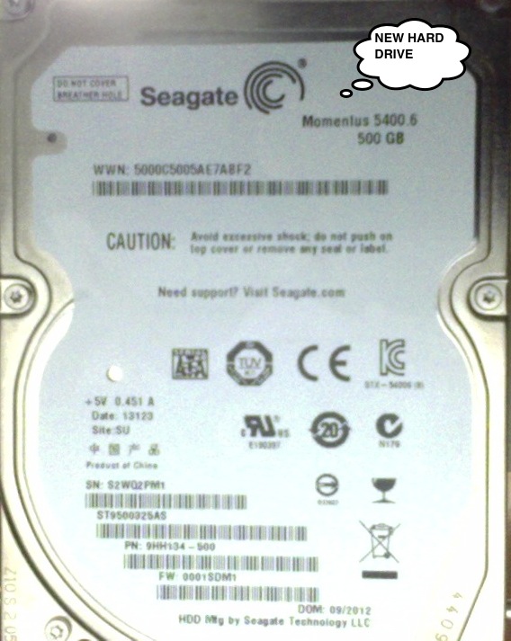

Check this out: I have a Mac book Pro A1278 13'. The hard drive crashed, can't be accessible anymore so I bought another HD, kind of the same, but without the logo apple on it... has the S-ATA HD be compatible with mac?
My MBP has this hd installed: Momentus 5400.6 500Gb PN: 9KAG34-041 with a Apple logo close to the bar code.
And the one I got, hasn't the MAC logo on it... has to?
-- When I put my OS setup disk, if the old HD is installed, I am able to see it on the Hard Drive Utility, but when I install the new one or any other SATA HD, like for example a 250Gb Sata HD, it just doesn't even recognize that there is a Hard Drive.

PD. I am attaching a couple of pics with my two hard drives.

well, for those that might help... I found that my new hard drive is completely compatible with my MAC, here:
http://www.seagate.com/internal-hard-drives/laptop-hard-drives/momentus-laptop/?sku=ST9500325AS
But I wonder, if I need to do something in the MBP Bios, like in the PCS, that something is possible to change... any ideas of why my new hard drive doesn't appear available on my computer? I installed a different one, SATA 250Gb and as well, nothing, doesn't appear.

Your Mac should be able to recognize the drive right away. The Apple logo has nothing to do with this, infact Apple is installing that same drive on new cMBPs.
Based on the facts you have provided I can tell the Hard drive cable is bad and not the HDD. The 13' Hard drive flex cable has a high failure caused by the bottom cover putting pressure over the bend on the optical drive.
Try with a new cable, they're really inexpensive.
Hope that helps.
