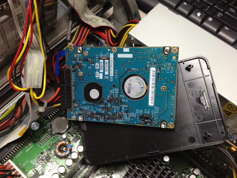

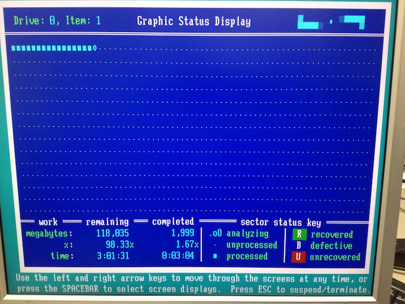

Sounds like the HDD may have some bad sectors. you can bring it in to Apple and seek a replacement, or you can replace it on your own.
If you have access to an IBM PC, you can take the HDD out of the MBP, hook it up to the PC and run the DOS based program Spinrite which can recover and repair bad sectors on a HDD.
I use it all the time and recently ran it on my old MBP HDD as a regular maintenance routine. I've also recovered many Windows BSOD's caused by bad HDD sectors.
