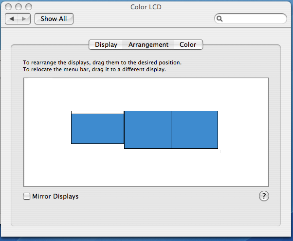

I used to swear up and down that splitting DVI would not work (probably because it really didn't, at least for a time). However, just last week I was talking with my friend who has a new Santa Rosa MBP. He mentioned how he was using his two 19" Dell LCDs with it. I stopped him and asked him...
"Two external LCDs on a MacBook Pro? How do you have them hooked up?"
"DVI splitter."
"Well they're just displaying the same thing, aren't they?"
"No, I've got three distinct screens -- the two externals and the MBP screen."
I made him take a photograph of the setup and email me a screenshot of the System Preferences display panel -- even though I would trust this guy with my life, I just found this really hard to believe -- and it was true. He had three distinct screens seen by OS X with nothing more than a $20 DVI splitter.
I have no idea how this could work, because I know in the past (and everything I know about digital signals also tells me) this wasn't possible. I'd love it if someone could come up with a solid explanation for this.

Can we please see this photograph and get a model number for the device?
OK here's the screenshot of his MBP's display preferences, and the DVI splitter he's using. I can't find the picture of the setup, he IM'd it to me via direct IM and I don't think I saved it.
The display preferences is showing the MBP's 1440x900 LCD and two 19" Dell 1280x1024 LCDs.

I don't think a DVI splitter like that is what you want. That sends a single DVI signal to two monitors. The MBP has 2 DVI signals on a single DVI shell; that is how it drives the Apple 30" display. What you need is a cable that splits out one signal to one monitor and the other signal to the other monitor. I don't know what this kind of cable is called, but it certainly should be possible; it is the same principle as a two-line telephone cable splitter that allows you to hook up 2 phones, one to each line.
That was exactly my theory about the splitter my friend has (see above) that allows him to run the two external single-link DVI monitors. It's the only way I can think of how it might possibly work. His office bought the DVI splitter though so he's not exactly sure where it came from. I'll see if he can dig up exactly what its model number is.
You know what also might help are pictures of the ends of his cable (if he's willing to snap a few more pics). The pin pattern may give away if it's dual-link on the source side and single-link on the two output sides.
