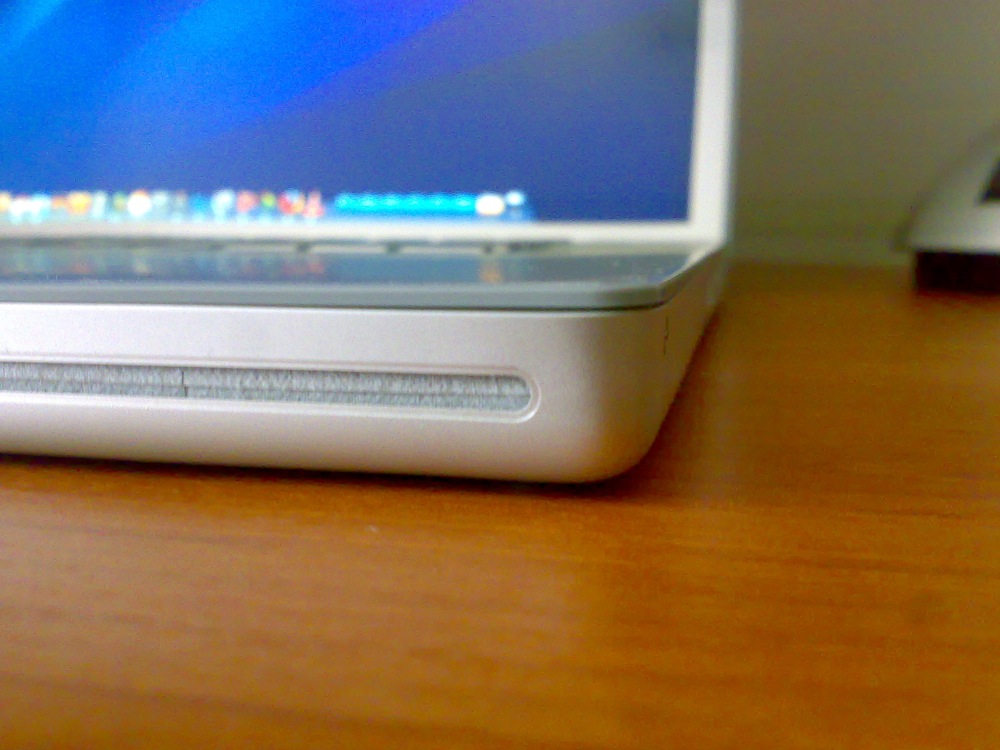

right edge is rising... and isight green On indicator doesnt working .. acceptable?

I could live with the rising of the case(though is there and i do not like it.) but no with the iSight problem...
what did they changed?😕
Oh.. they missed the front clip... that is easy to sort out! Just apply some downward pressure around the DVD Slot and it should clip.
However the iSight indicator not working... Umm, that's not acceptable, not for me. How long was the turn around for the repair?
Be careful when you do this though. If you apply too much downward pressure you'll end up bending the bottom part of the case down, completely blocking the DVD tray! I know cause i JUST made this mistake and fixed it by sticking a screwdriver in and bending the case upwards.
The LED light problem is enough to warrant bringing it in to the Apple Store, and be sure to tell them how the problem with the case wasn't there before, and if you are going to bring it in, then don't bother trying to push the thing back down and risk damaging it more, because then they will definitely not repair it, and will void your Apple Care.

is there any instructions somewhere how to connect the cable?
just take it back. One time I had to go back 3 times since they had forgot to do something each and every time. So don't let it go. They will fix it. don't think run to the apple store and get it fixed. 😀
x99 to take it back. Dont risk taking it apart and breaking something unless you really want to do it or know how to do it. Also, you'll need Torx screwdrivers for MBPs, as well as fine screwdrivers.
personally i've taken Macbooks apart so often i can do an LCD replacement without a manual. 😉 says nothing about their quality though. 😱
Macbook pros are actually not to hard to take apart. for the corner, if you can find a screwdriver that fits, loosen the screw closest to that area and press down on the edge. Retighten. Sometimes the threaded tab gets bent when the tech puts it back so it doesnt sit straight as before.
if the LCD has been replaced, chances are its the entire clamshell (2nd gen MBP and later). It could either be defective or they forgot to plug in the cables.
Definitely take that back and get them to finish the job, that sucks getting it repaired and then it coming back like that. Next time you get it back, do a thorough work over with the Genius. They did that when my MBP was in for repair so as to make sure everything was good before I took it home.
Same happened here with my MBP after I got it back for repair. The left side of the case was popping up a couple milimeters. Brought it back and they had to send it in again to have the top case replaced. Make sure you call or tell them about it ASAP otherwise they might think you did something to create that problem.
