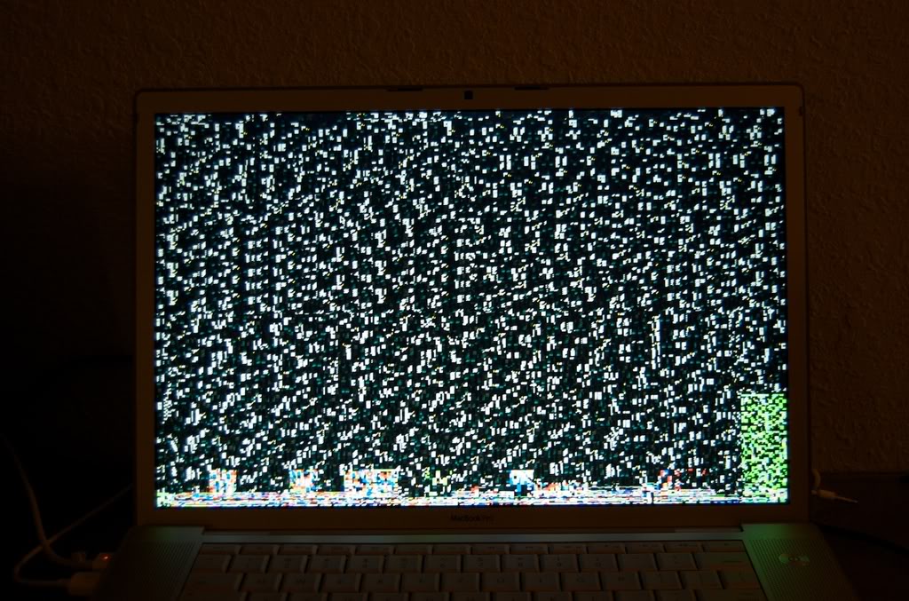

i close the lid and the laptop goes to sleep
i close it in the middle of work (was listening to music, writing email and so on, so all my applications are opened), so i close the lid, it goes to sleep, after a while (doesnt matter how much time, really) i open it and see this:
http://img102.imageshack.us/img102/4509/p1140091vi3.jpg
(mirror: http://maccentre.ru/board/files/p114009111_142.jpg )
obviously i need to force restart (shut down) the laptop
is it because any the of programms that i have ? cause that's what i've been told but to be honest i have no idea what kind of soft might be causing it..
any help please ?

i had the same a few times, but the login screen was ok and after logging in it was gone😕
defective video card
go to an apple store
not much we can do about defective hardware
and i really dont think thats software related
but if it's a hardware problem and because of the videocard, shouln't it be not working at all ?
cause after rebooting it's ok now
i thought if something's wrong with the videocard, it just should emm not show anything at all...
it's working fine now, but it scares me, kinda...

A reboot (which usually takes sometime after this happens) always fixes it. Plus, if its a hardware issue, from what I've seen on other cards, shouldn't it show up when the GPU is under stress? I've played long hours of Crysis on this with no visible artifacting..

I've had my 2.4 MBP since the end of February 2008 (the new Penryns), and I had this problem for the first time last night. Before bed, I put the MBP to sleep, like I usually do, plugged into the external monitor (MBP lid shut) - only Adium was running, as usual.
About 10 minutes into getting to sleep, I hear the Superdrive kick in, and the machine wake up. Turned on the external monitor, and saw an image not unlike the few we've seen in the thread. I unplugged the DVI cable to the external, and nothing showed up on the MBP LCD.
Needless to say, had to force a reset via the power button - hopefully it won't happen again! And I sure hope it's not a hardware issue!

This is not necessarily a good thing because you need to troubleshoot the darn thing instead of just bringing it in to an Apple Store and let them fix it. First of all, I would recommend that you keep a list at hand where you write down which apps you have open when putting it to sleep and when the error occurs. After a few times, you can narrow down the culprit. Then try sleeping your laptop with only the suspected apps open. If you find an app that is open and produces the error consistently, huzzah! If not (and this is most likely) you should try a reinstall, reset PRAM, SMC, the usual trouble shooting stuff. If this does not work, then it's most likely a hardware issue.

I had the same pixelated problem and my AppleCentre said it was a logic board problem. Get it replaced.
That seems to have corrected the pixels but sometimes I get the problem where the MBP wakes up but with a completely black display. Pressing F2 doesn't brighten the display and, eventually, I have to shut it down and restart.

For those of you who have experienced this problem, and actually gotten a replacement for your MBP, do you show them evidence of this? Photo of it happening? Describe it in words?
I definitely want to get this fixed/replaced if I have to, but I'm worried they may not believe me. This would be my 2nd replacement (replaced it one day after my original b/c of the yellow screen problem). Do I just wait until it happens again and take a photo? Are there ways to replicate this problem? I've only had it once (see my earlier post), but I want to fix this ASAP!

The one time I experienced this pixelated problem was Sleeping the MBP via the Apple menu, hooked up to my external monitor with the MBP lid closed.

I get the same issue. Seems to be related to SMCFanControl.

To help you troubleshoot, the only programs I had running when I slept it and it auto woke pixelated were:
Adium
Google Notifier (mostly to notify me of GMail)
