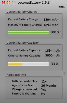

Hello all. I have a battery issue, and this thread seemed like the best place to post. I have a 2.33 C2D MBP and maybe 8 months after I purchased the computer the battery was draining quickly. I called Apple, we did the diagnostics, and they sent me a new one. Below are the stats of the replacement battery that I have had for a little over a year. I really noticed it yesterday morning. I was typing a word document with wireless on, but Safari was closed, and by battery went from 100% down to about 20% in just under an hour. I do have AppleCare. Do you think they would replace it again if I called in?
Thanks!
